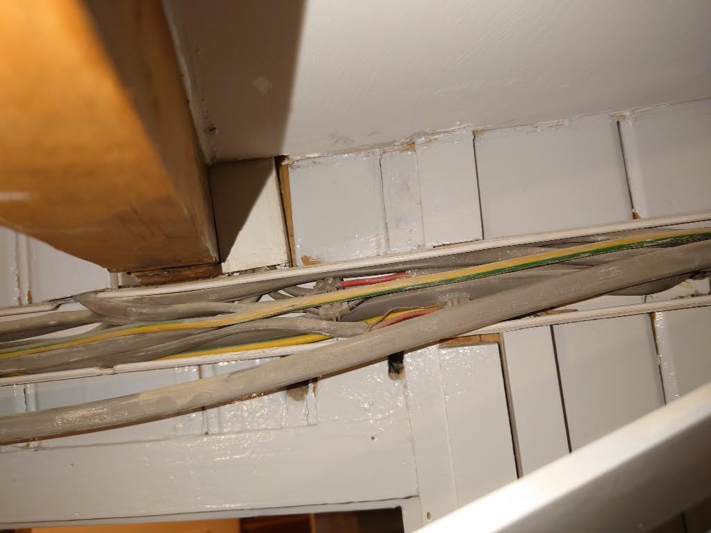

I'm looking to get an EICR done and just looking over some things so that I don't get too many surprises. Upon looking inside some conduit running across the ceiling in the lounge I found a few places where the T&E is joined using chocolate blocks. Is joining the wires like this permitted? It has been like this for decades. Part of me is tempted to wrap insulation tape around it but part of me thinks hidden dangers are worse.

That's trunking not conduit. Bare earth conductors should be sleeved in green/yellow . It's not particularly good practice to have joins in cable hidden in trunking ,and there are more professional ways to join them rather than those screw down connectors.
Surface trunking is actually quite easy to work with, if appearance does not matter. You can take the lid off and replace unsatisfactory cables.
As the connections are accessible by removing the lid of the trunking I do not think there is any requirement for them to be Maintenance Free.
Some tape round the choc blocks would prevent accidental contact with the terminal screws. But I agree, hidden connections are not ideal either. Perhaps a good compromise would be to turn the choc blocs over so you can see them but the screws are facing the base of the trunking.
I think I'm at the point where I need to get the EICR done anyway. I know that I'll need a new distribution board since there are no RCDs so I'm fully expecting it to be a multistage process. Hopefully replacing some of the lighting circuit (I think that's what they are) shouldn't be too expensive. Last time I had an EICR done at another property the contractor replaced a light rose that had a hairline crack and fixed the new one to the wall with only one screw and sitting askew where the cable came in. Hopefully this next one won't cause more problems than it solves.

Got the EICR done today and whilst the guy was really thorough and helpful he wasn't interested in the contents of the trunking. I had put sleeves on the earth wires as suggested. No bodges this time unlike the EICR I had done on another property with another company who I will never use again after they replaced a lighting rose with a hairline crack with a non-cracked one but fastened by only 1 screw so the cable could enter from the side because they were too lazy to use the backing box I provided.
Turn the power off, tighten up the screws in the choc bloc then turn the power back on.
If it's been fine for umpty years it has a good chance of being fine for umpty more.
