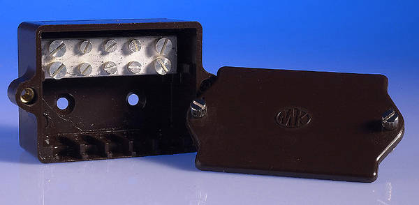

Connection a junction box to a 10mm ring
large junction box, designed for high currents (e.g splittint meter tails to 2 CU's etc

What is a "henly block"
Bottom photo shows the inside of a single-pole one. You can also get DP versions (top).
