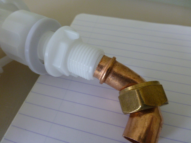

Does a standard 1/2" float valve take a standard tap connector?
I'm working in plastic push fit and just bought a JG angled fitting from Toolstation and the spigot in the fitting is too big to go into the 1/2" float valve.
Is the JG push fit a non-standard type?
Will I need to buy a normal angled solder tap fitting but will that fit?

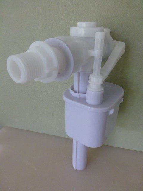

Yes, a side entry valve. I've looked at copper tap fittings and they also have a spigot end. I'm wondering if the wall thickness on the plastic float valve is thicker as the threads are so vulnerable than the a brass fitting

Soundsore like the Op has bought a spigot push fit elbow (stem elbow) and is trying to insert the stem up into the valve tail. You need to replace this with either a 1/2" swivel x 15mm elbow, a 1/2" x 15mm straight swivel or a 1/2" x 15mm flexible tap connector.
Assuming you really must use push fit!

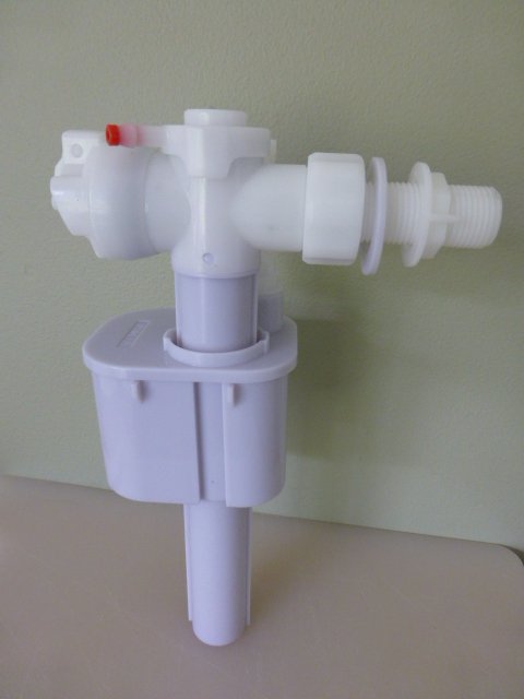

Problem solved, had to replace the float valve with a brass ended version. All the tap connectors would not fit into the plastic threaded valve. As I said it appears that they are made to take the 1/2" end of a flexible hose type adapter.

Nothing will fit "into" a threaded float valve.

Photos as requested.
You can see on the 2nd pic how thick the wall of the thread is and this prevents the normal spigoted tap connector to fit in.
Actually the whole fitting doesn't look bad quality.
