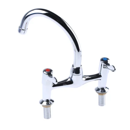

I'm going to be fitting a tap like this one:
And just wanted to check that this is the correct part for connecting to 15mm copper pipe using compression:
If not, please could someone let me know what the correct part would be?
Also, are the rubber mounting washers that come with the tap enough to make a good seal to the worktop? Or is it usual to add a little silicone as well?
Many thanks
It is correct ,if the thread of the tap is half inch BSP.
Unless the hole diameter in the worktop is too large ,the taps seals should suffice.
