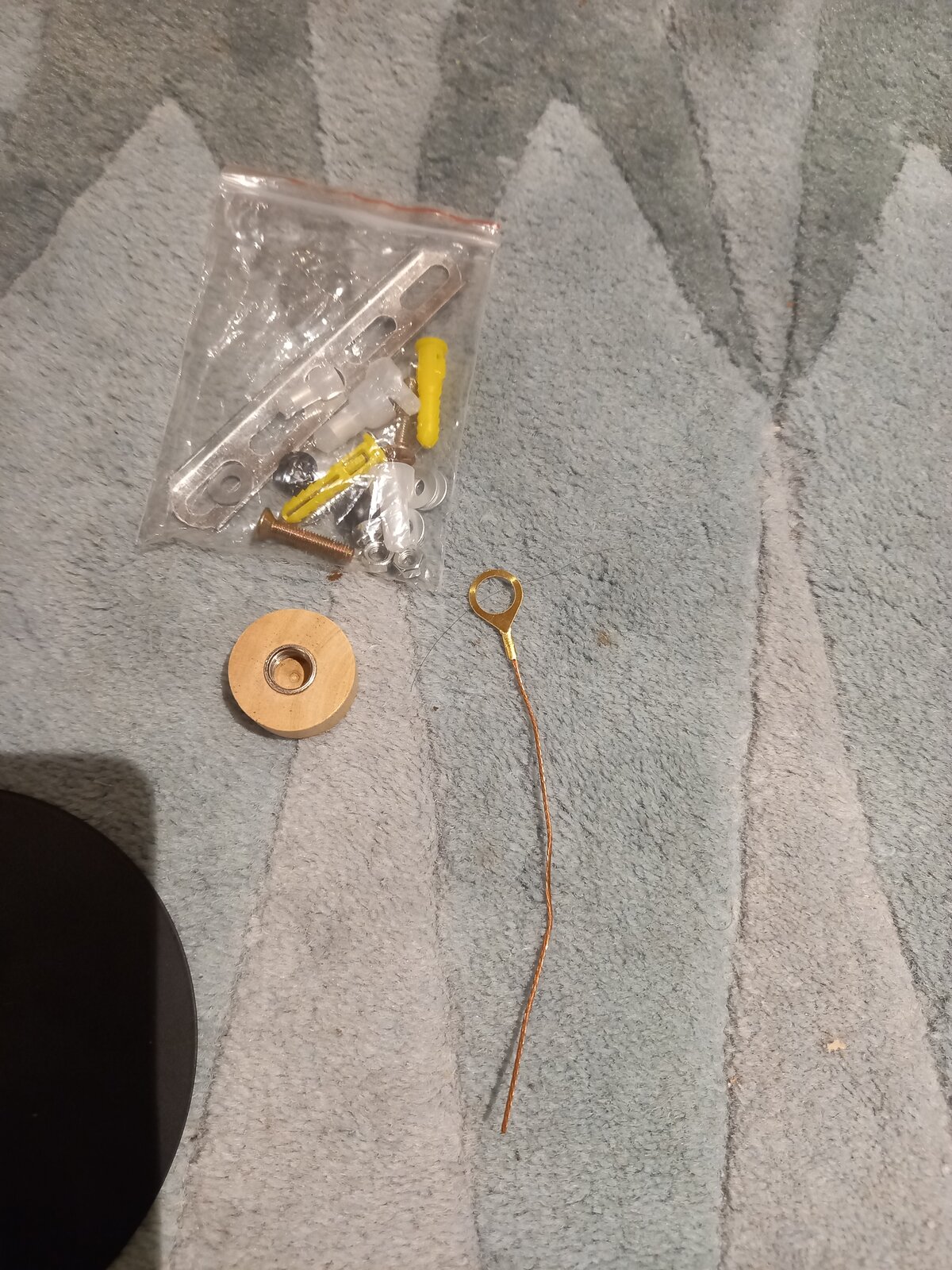

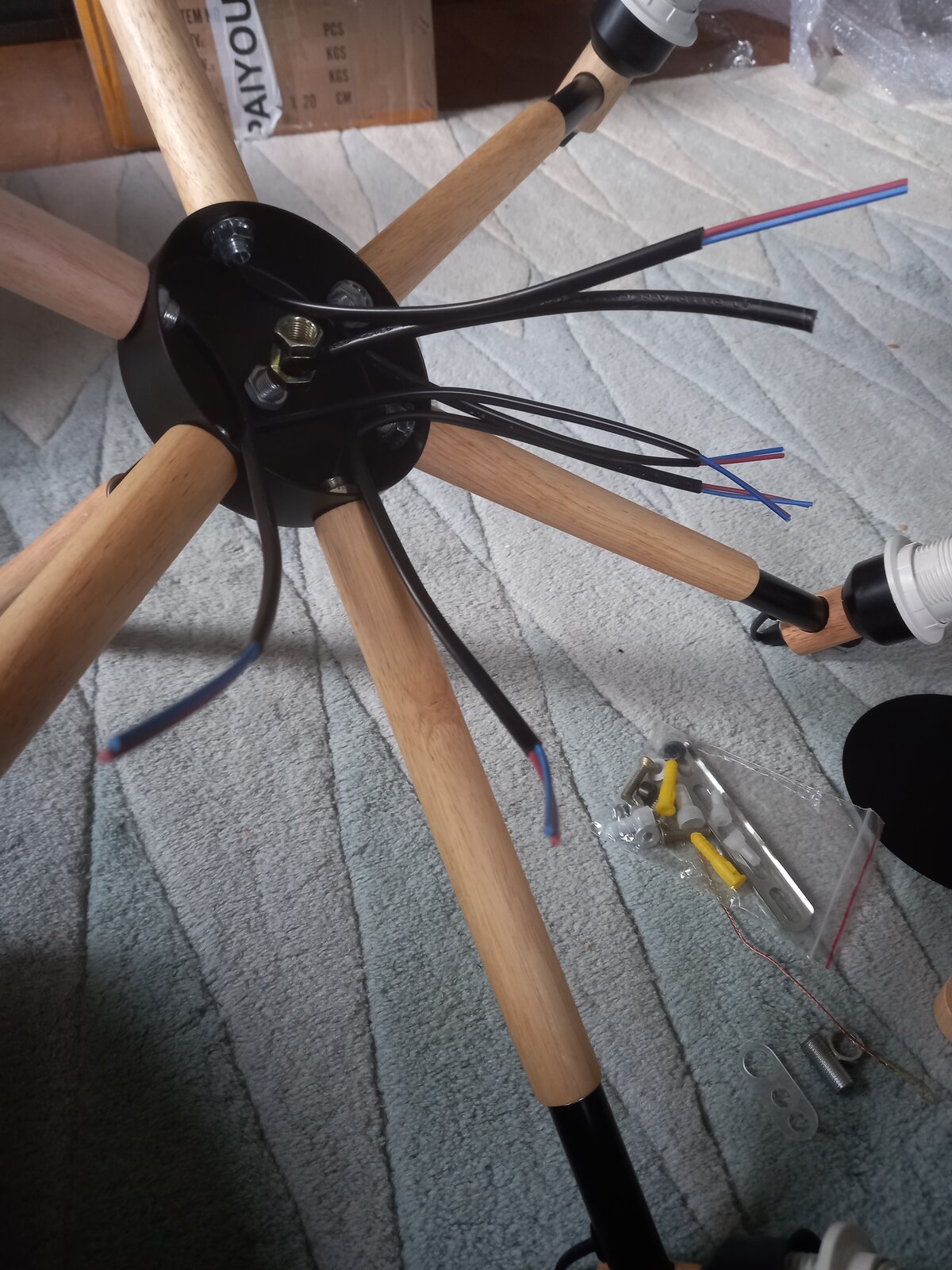

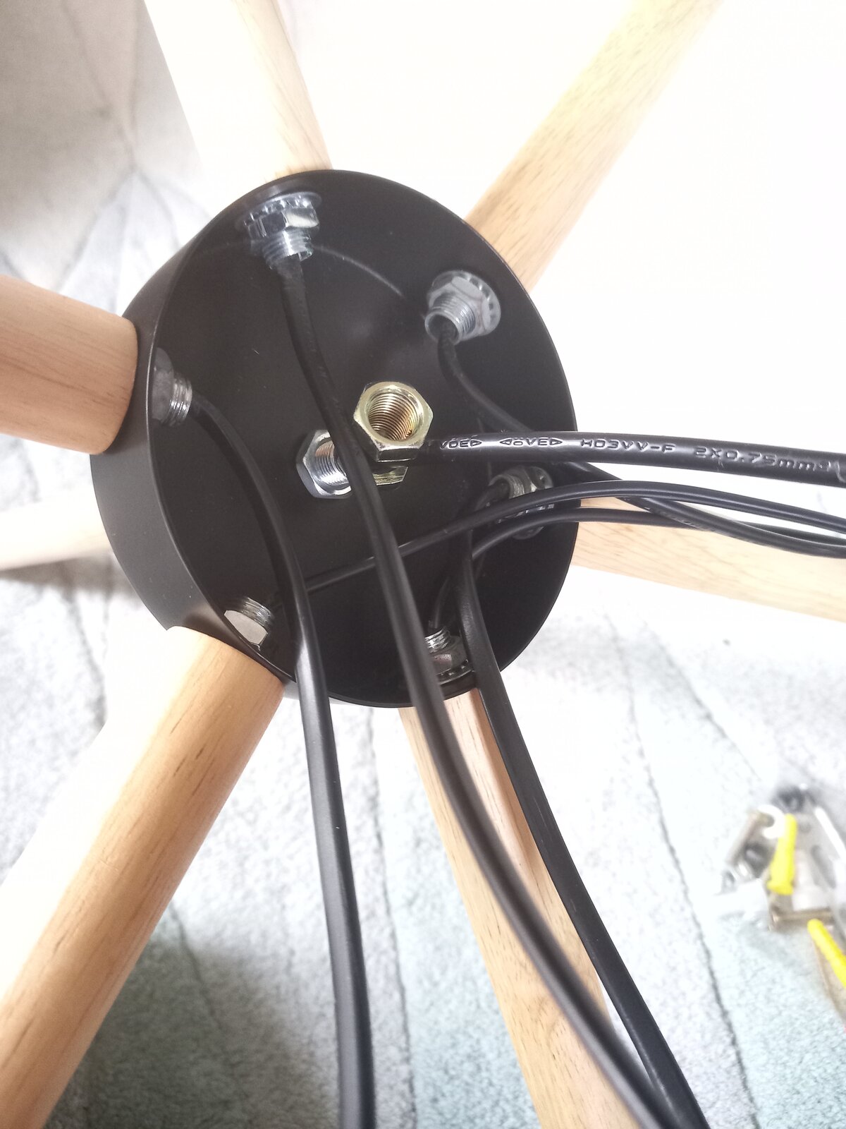

I've just purchased a couple of light fittings, direct from China. They come completely dis-assembled in a couple of small cardboard boxes and can pretty easily be put together. However, there appears to be the wire-connectors missing that go inside of the fitting, connecting the six arms to the main power wire (see pic).
Can anyone send me a link please to the type of connector needed?
Would it be a single connector and I stuff in the whole six wires or, should I use three and three and then join these?
What is normal practise?

Mmm... Looks like some 'wirenuts' in the bag (shudder). Americans use these to screw on to sets of wires to join them together. Although they are relatively effective when they work, I would never use them as it is hard to verify correct connection. If it were me I'd probably get some wagos, but they probably don't go up to 7 way. Choc block is probably the simplest bet here. I expect you could get them all in one way of the choc block but play it be ear.
one live wire per "receptacle/hole" on the wago and four in one then link to the other one that gets connected to the supply, repeat for the neutrals.
and those supplied "wirenuts mentioned dont look any where near big enough to accept more than a couple of wires so bin them
Often they are connected with wire nuts or crimps, then shrink sleeve used. I however I split the lights, DSC_6062_1.jpg so I could select how many bulbs are lit, and used a smart relay. What you do is up to you, the main problem is getting what you use to fit in the space, may have to use crimps to fit in that space.
I am willing to be corrected, but as I see it, you currently have a double insulated light fitting - any of the solutions involving chock blocks or Wagos mounted in that small space, would lose the double insulated nature of the fitting.
You would probably need to attach an earth connection to the metal hub (not the most difficult job).
Alternatively, you could connect the wires into a lighting connector (i.e. Greenbrook ), or a maintenance free junction box, that would slide up into the ceiling void. This would not require any further modification to the light fitting, to maintaing it's double insulation.
EDIT: one of the cables looks a little thicker than the others, could it be 3 core?
Look more like crimps to me. RS call them "Closed end wire crimps". Wirenuts are typically harder plastic and brightly coloured (to size/wire gauge).
Not sure how they work with any double insulation requirements (copious heatshrink)?

I do see your point. I wonder, though, why they provide these to an end user, without the appropriate tool.

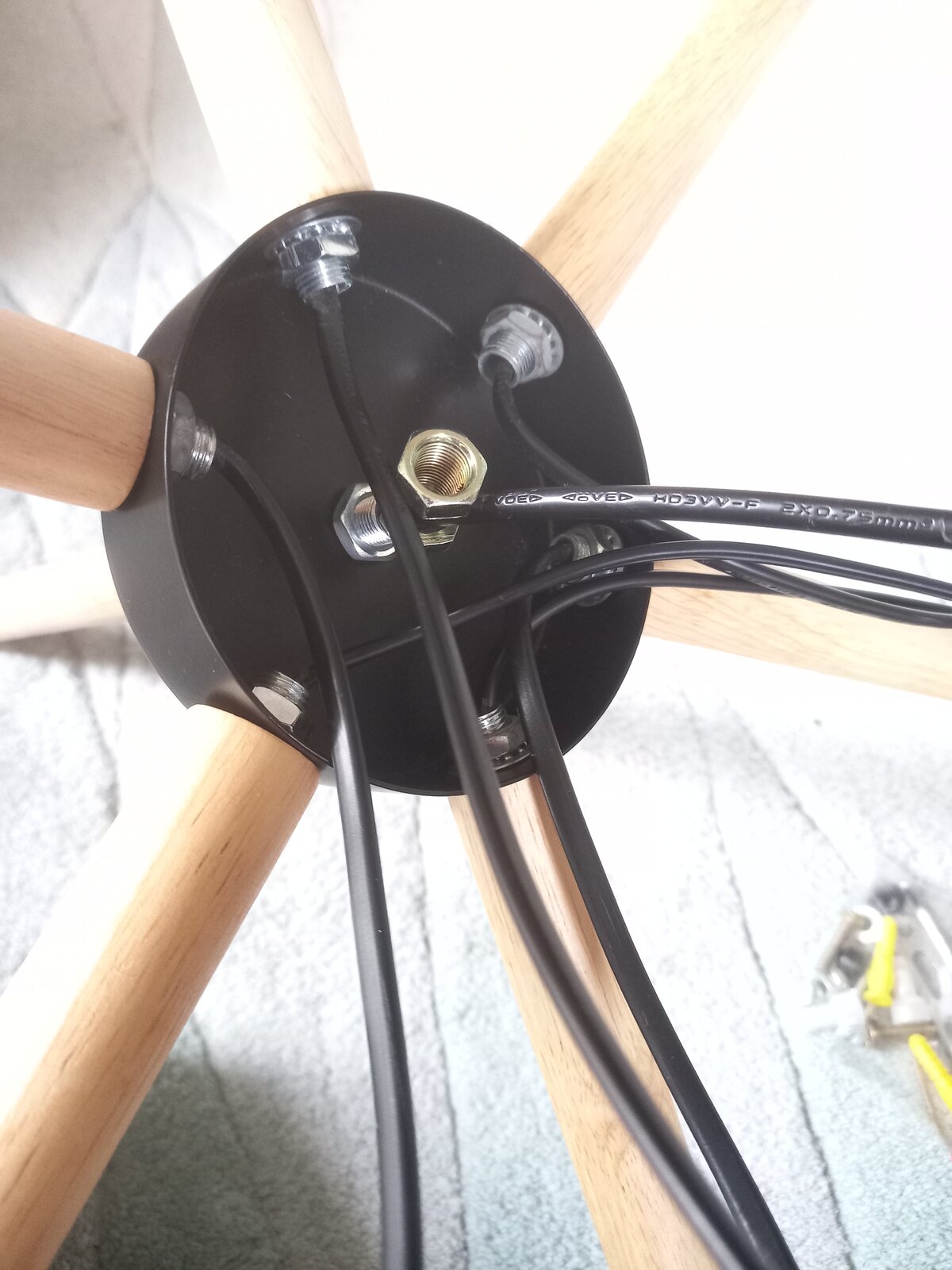

The three-prong fitting, (I bought a 3-prong and a 6-prong) I've used a choc-block as only 4x wires in total of each live and neutral. Soldered the pairs together before screwing into the block. For the 6x prong fitting I'll purchase a Wago or similar I think.
The single, thicker supply wire is two-core.
I do have an earth-bond supplied. Where about should this go? I was going to put it in the top-end / ceiling rose.

Is there no earth conductor present in the supply cable ?
You indicated it's only 2 core ?
There is nothing about the fitting in your first pic that suggests it's double insulated ,class 2 fitting.
