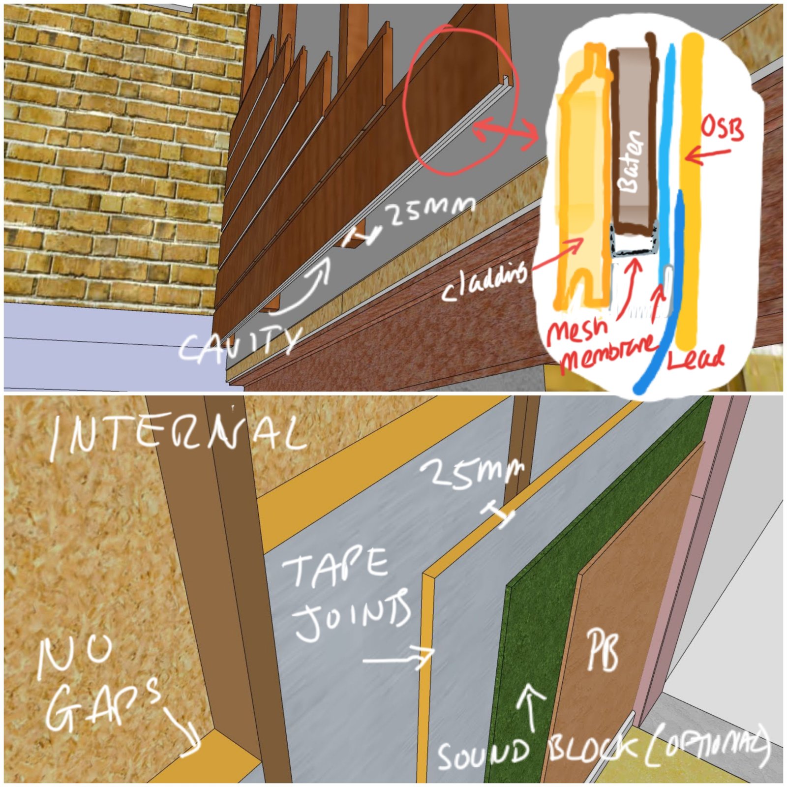

Hi I'm building a conservatory to the rear of my house. The floor will be raised by 600mm due to steps on 4x4 posts and 6x2 joists then a 600mm dwarf wall built ontop to sit windows. What would the best way to insulate this with?
I was planning to use 50mm alreflex platinum insulation boardshttps://www.thermal-economics.co.uk/main_products/alreflex-platinum/ I can get cheap locally in walls and floor with cladding externally & Plasterboard inside with 18mm osb ontop of floor joists. Would I need to add any kind of sheet behinds the cladding and vents for moisture buildup??

It is foil faced on one side so I was going to double 2 boards back 2 back to give 100mm insulation with foil on both side,.
In relation to the wall sheet i meant like a waterproof membrane or breatherble etc, it's going to be a timber stud timer Clad 600mm high for the windows to sit on

Timber frame walls need a vapour check membrane on the inside of the frame, and then a waterproof and breathable membrane on the outer face. Then a ventilated cavity would be prefferable to not having one.

Insulate studs flush internally which is foil backed and foil tape over the joists to form a complete barrier this acts as the moisture barrier then externally osb/ply which apparently is best to but can be skipped, vapour barrier, batton and clad???
Insulate BETWEEN studs and foil tape, then another layer ACROSS the studs, (foil tape again) to prevent shadowing. adding a layer of foil back plasterboard (duplex) will finish the VB process.
You would staple a breather membrane across the studs externally. A layer of ply would add stiffness and prevent racking, probably not needed in this case.

Like this

Is the lead optional
The idea of the lead, or it can be DPC or suchlike, is to form a drip from the cavity so any water running down the cavity can drip away, and it needs to be something that wont be degraded by UV.
Also its good practice to keep the frame 150mm above any ground level or paving (two course of bricks), else you tend to find the rain splashes can cause problems to the bottom of the cladding - either rot or staining.
