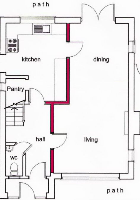

@op; the floor joists will be spanning from the internal wall onto the outer wall. They will provide lateral restraint to the outer wall.
A lot of things will stay up even though a structural engineer wouldn't be able to prove it on a new build.
Although having said that a 4 inch wall should be pretty stable for one storey, in our house the structural engineer was concerned about 2 inch walls buckling after the chimney was removed but they had ended up completely unrestrained at one end of each.

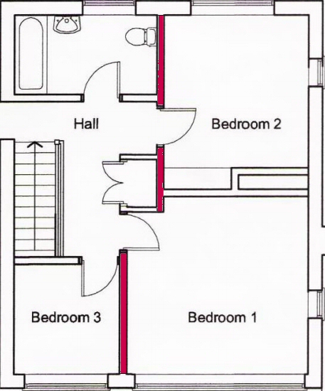

Hello,
I've attached two images, one of the wall (in red) downstairs and one of the wall (again in red) upstairs.
So downstairs there is nothing abutting the wall, it is one long wall with an offset and two doors. The longer section is about 4.2m, the shorter about 3.45m.
Upstairs the wall is abutted in a few places.
So why is this wall stable? Surly some downstairs abutments are also needed?
Thanks,
