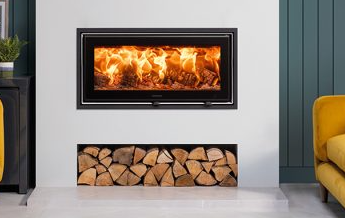

Hi all,
I'm currently building a house and the downstairs living room is going to have a media style wall with an in built raised fireplace and I'm hoping for some help regarding constructional hearth requirements.
I've looked at the installation manual, read through the building regs, searched this forum, used AI, but cannot find the info I need.
The fire is a Inset Cassette Stovax Studio 2 and the finished design is going to be something like this...
Would the constructional hearth be located at floor level in this design and if so would my 150mm concrete floor act as the constructional hearth?
Any help would be much appreciated.
Kind regards,
Mark.
I've managed to get answers direct from techincal guys at Stovax and if it helps anyone else here they are..
The constructional hearth would be located at floor level and a concrete floor of 125mm would suffice.
Also note that the image in the post does not comply with the installation instructions as no combustible material is allowed below within 600mm of the bottom of the fire.
Mark.
