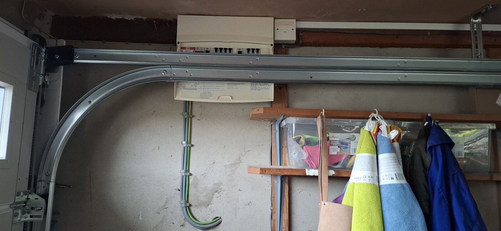

Hi all.
I have just had a new Garador garage door fitted. I didn't realise it at the time but now that it is fitted the runners are in front of the consumer unit. The CU is not inaccessible but I now cannot shut the front cover nor can I see the fuses with getting close. Anyway would it be possible to have the CU moved down without the spark having to do any other work. Would he be able extend the existing wiring without having to do a complete house rewire. Also would he need to do an EICR( I think that is what it is called) and if any of that work is possible then a, very, ball park price figure would be appreciated. I am aware that the present CU would have to be changed for a steel one..........Those runners are not actually as close as the picture suggests but they are close enough to prevent the CU cover from closing.

Those garage door fitters were dumb. Moving the CU down will almost certainly mean adding an enclosure to all the existing cables to be extended.
I would recommend that you fitted a complete new CU with RCBOs and SPD too
Well perhaps I should have checked as work progressed which I didn't as, rightly or wrongly, I tend to leave tradesmen to get on with things. Anyway I do realise that the runners will have to be removed and I can do that. But can they replace that CU with whatever RCBOs SPDs new CU etc etc that is needed without having to rewire the whole house because obviously the present set of wires would not reach a lower down CU. Also, if possible a very very rough cost for the job.
Good grief! How thick were those door fitters? IMO your redress is with the door supply & fit company as it must have been obvious that the CU would need full access for fault clearance/isolating of circuits etc.
No rewire required
Where are you in the UK?
Come across this type of thing a few times, mainly kitchen fitters boxing CUs in preventing the lid being removed
A reasonably easy job, but to move that CU the electrician will need access to the existing unit. The runners will need removing to do that.

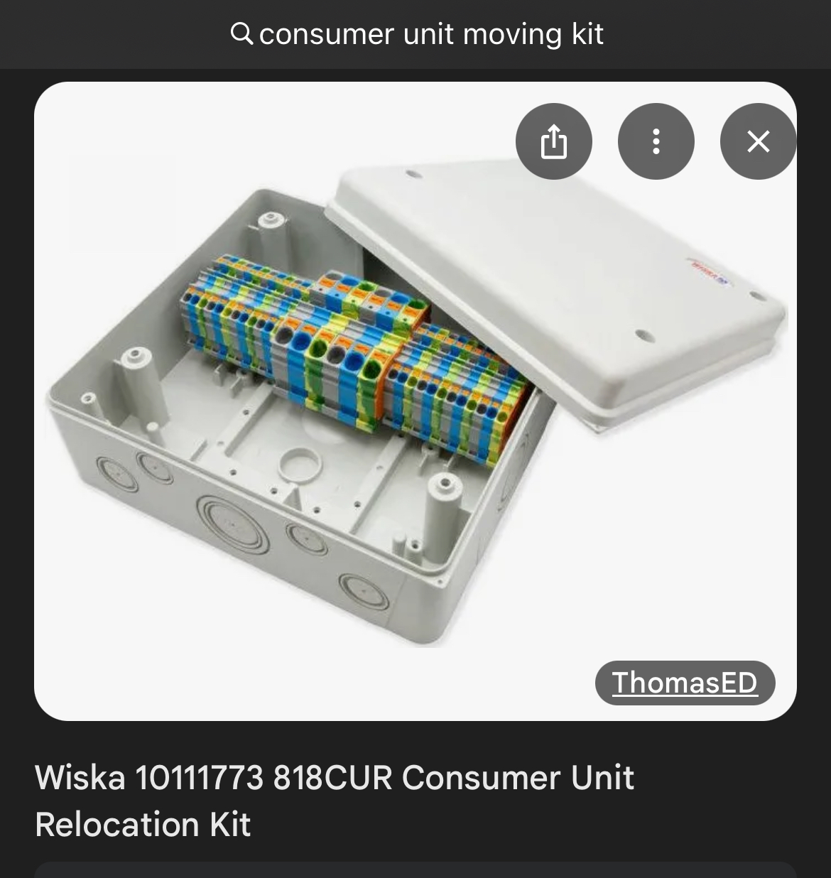

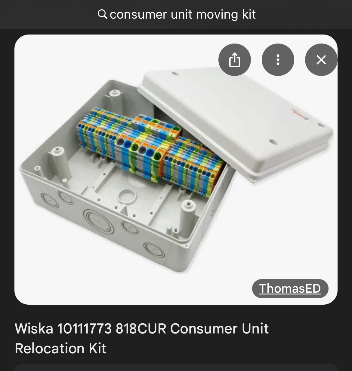

Fit one of these where the existing CU is and mount the old one (or a new one) lower down.

PS my suggestion of the Wiska box was a serious suggestion ( not available in 2011). It does come at a cost though!
It was in no way meant to criticise the OP, who is a victim of circumstance.

But to price not easy, I have worked on some jobs, where the big expense has been getting to the job, due to parking restrictions, not saying that would be a problem here, but until one has been on site, one can't really work out pricing. But it will not need a rewire, @Taylortwocities has show what will be likely used to extend cables.
