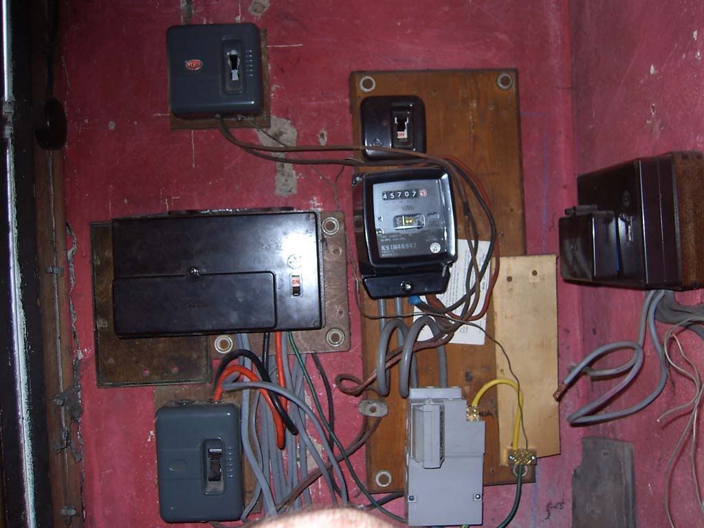

Recent posts of dodgy CU's has prompted me to dig out an old piccy once hosted by darkernet.
This Standard Wylex board is fed via the metalclad unit below it, via a 15A 3036 and cotton covered tails of about 6mm2....
Begs the question of why the 15A switchfuse, and did it blow often, looks to be an 8way wylex board, much load on it?
The switchfuse appears to be unearthed, as does the (redundant?) switch fuse above the meter
Whats with the disconnected wylex board on the right?
Did you get the job to replace it all? did you snip the meter seal and replace the 3 cloth tails with 1 lot of pvc 25mm²?
What about the spare wylex board on the wall to the right? I'm almost afraid to ask where that was originally supplied from.... :?

Bit of a dodgy install, but not too big a job sorting out. The correct way to go with this is to get the DNO to upgrade the tails (it's a criminal offence snipping the meter seal) and fit a DP Main Switch. From there it's a straightforward board change.
PS. Looks like the installer has used coat hangers to provide a link between the top switchfuse and the MET.
Good grief. So he has.

How did the DNO replace the main fuse and meter (at some point), and not notice that the installation it is feeding is quite unsafe? The worst bit about that picture is that it appears someone has been tinkering very recently, using blue tape on the neutral on the meter. :shock:

No, never according to the customer.
It was!
It was for S/Heaters.
Yes. No, UU did it*. Yes.
* I argued with UU about the earthing arrangements, which was an EC14 on the sheath. They said it was fine, I showed them my Ze readings of 0.95 and 0.89 (not much over, but over nonetheless) and forced them to fit what you see in the picture.

Actually, no.
It's the old solid strand bare copper earth wire twisted together with another.
Just looks very like a coat hanger!
Crafty: the blue tape was crispy when I took it off. Ancient. Must have been put on when meter changed years before.

It looks to me like the old s/f is earthed via a bare copper conductor which is twisted together with another coming from the "redundant" s/f above the meter.
The new digital meters being fitted at present are a result of a million pound fine dished out to energy companies for non accurate metering. Almost all "old" style meters are beyond accurate calibration for any relevant period of time.
When Meter readers, fitters etc come and see no seal...they either ignore it or fit another..nothing is ever done.
The picture above is a classic example of a potentially dangerous practice of sharing neutrals. Usually carried out by stetson wearing so called electricians. It may not be the case above but you can see the probabilities.
Bunched cables into a meter is a serious "no-no" and will always be reported to the enery companies as a matter of policy. A couple of quid and a Henley block would have sorted that.

At least, the Cable Head unit or (Service Fuse Block) is in decent condition, and even comes complete with a PME earth facility.
Usually you see a nice modern installation, with MCB breakers, hanging off a century old lead covered supply cable, into a cast iron service fuse block, with a rusty tenby clamp for the main earthing conductor!
The service head was changed at my insistance because the earth originally came off an EC14 on the sheath....
It is not PME, but TN-S. You can just see at the bottom of the pic, abit of g/y covered braid coming off the sheath, which is attached to the brass earth block on the service head.
did changing the head bring the Ze down to an acceptable value?
