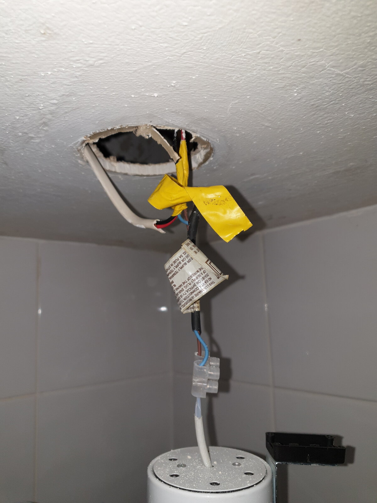

Hi, I was changing a bathroom 'light' 'switch ,which was actually a 45 amp pull cord shower switch controlling 4 downlights and the fan.( A separate switch beside the light switch has been installed at some point to feed an electric shower, but only has the supply cable connected). I connected the new switch, powered up and the socket mcb tripped and this has fried the consumer unit main isolator switch. On Investigation there is a loose , and split 1mm cable lying in the ceiling space which I am assuming is the cause of the short. The wiring to the downlighters is really poor quality work and certainly.ly needs to be done properly. No earth wires visible!. I will not have the chance to investigate further until tomorrow but would welcome any suggestions/ ideas. Why would a cable in a ceiling space cause this situation.

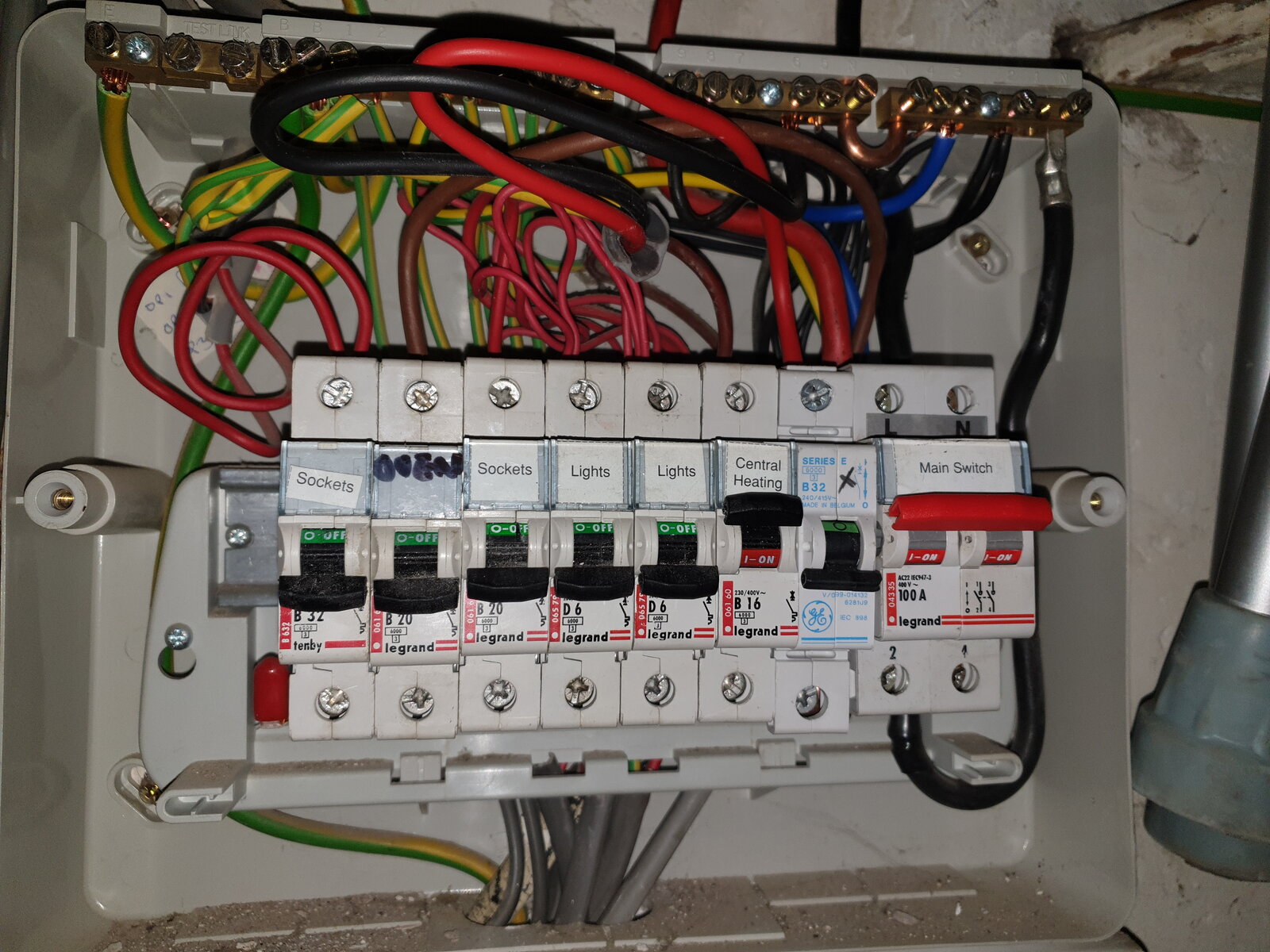

Many thanks for your responses. Definately MCB. Consumer unit is a Legrand, possibly a good few years old. As I mentioned the downlighter wiring is a mess . Cables terminated in chock blocks but not contained within an enclosure. I will try to get some pictures tomorrow when I have the chance to investigate further. Thanks again

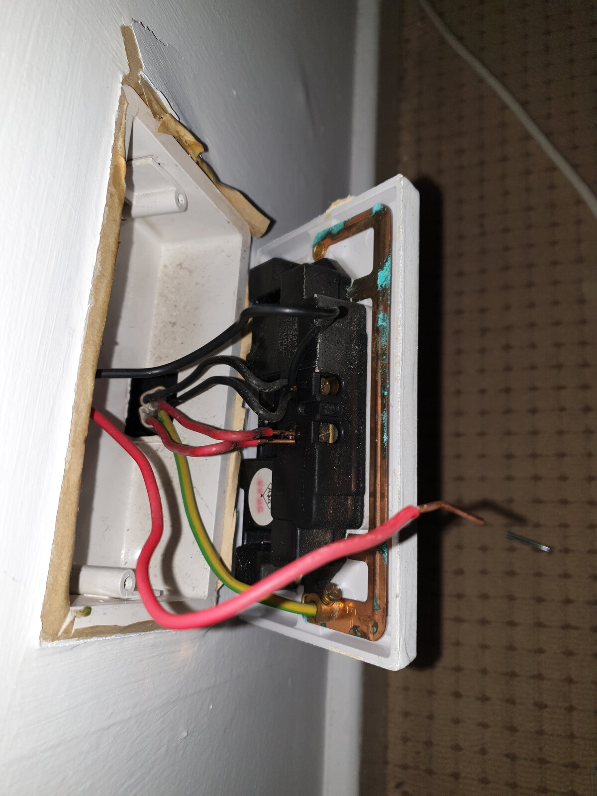

Hi, well what did today uncover? Someone at some point appears to have added a second ring main wired in 1.5mm cable and for some reason has lead a spur from one of the sockets into the bathroom ceiling space. This was the wire which had shorted out the sockets mcb. The downlighter wiring is appalling, as is the fan wiring. Anyway had a quote today for a new consumer unit and the guy is recommending an MK 10 way rcd unit. What are your thoughts on MK? My preference would have been Hager.
Obsolete since last year, contains the wrong type of RCDs, surge protection not an option and only chosen because it's on clearance special at Screwfix. Pretty much the worst possible choice.
Hager with RCBOs. Or same from Wylex, Crabtree, Schneider.
MK seemingly decided that all the new surge protection/RCD types/arc fault protection that is coming in was too hard and decided to get out of the CU market. Anyone fitting one of their CUs now for anything other than a short term temporary installation is either ignorant or doesn't care about their customers.
