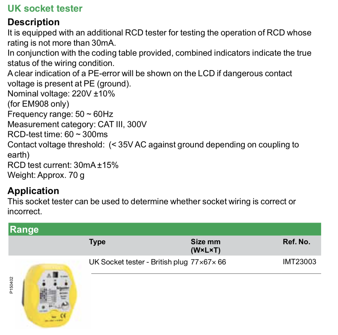

Using a Schneider IMT23003 socket tester, the three lights were as they should be on all sockets on the circuit in question (1st N off, next two PE,L on). However, on touching the contact electrode, the warning symbol showed (indicating a dangerous contact voltage present on PE- conductor), but only for four of the sockets on the ring, it doesn't show on the other sockets in the same ring. This isn't a display pattern explained on their coding table.

Well the Schneider isn't necessarily saying there's dangerous voltage on the cpc, just that there's a voltage difference between you and the PE from the circuit. The spec sheet says the threshold for this test is <35vac dependant on coupling to earth.
This could mean, due to the all important < that the voltage is much less than 35V.
I've not looked at the specs, but wouldn't that "threshold" mean that at < 35V it wouldn't give a warning?
You could be correct there. The spec sheet doesn't really go into more detail than I put in my post though so I can't expand on what I've written.
How can a threshold be "less than" whatever value?
It's certainly rather odd, since one is used to 'fixed' thresholds for alarms such as this.
As BAS has said, the threshold is presumably the voltage above which it will give an alarm. However, what Iggifer has reported suggests that, for some reason, they cannot given an exact figure for that threshold, but are 'guaranteeing' that it will be less than 35V.
I suppose that, particularly because of their qualification "...dependant on coupling to earth" they could be talking about the threshold relative to true earth, but I can't really see how they could give an absolute figure for that, given that the extent of the coupling between the body of the user and true earth could be anything (theoretically including 'almost zero').
I think we need to scrutinise the documentation a bit more deeply, and see if any clarification is there to be had!
Kind Regards, John

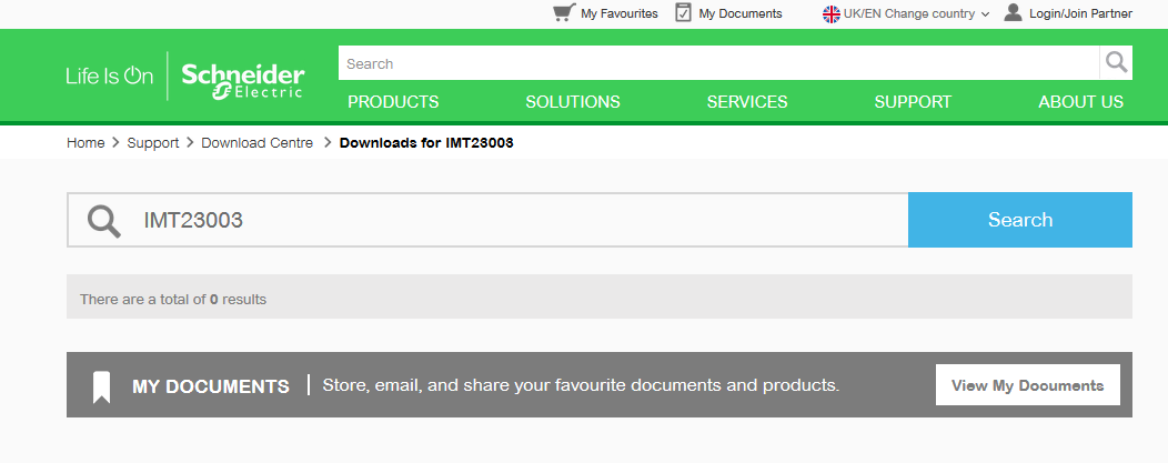

Sadly no user manual on the Schneider site.
