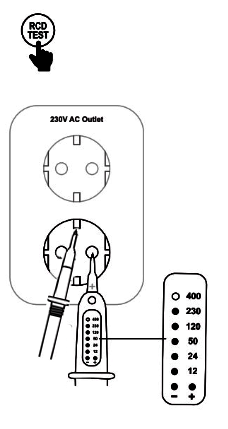

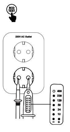

I do see the problem the instructions show upload_2022-3-29_5-14-39.png with a German "Schuko" socket that could not possibly test the RCD. upload_2022-3-29_5-26-28.png This is what I would expect to see.

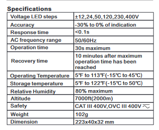

I found a second Set of instructions which seem better. However the specifications
say operation time 30s maximum, this does seem odd, most test probes you can use for as long as one wants.

However as far as this tester goes, 30 seconds use then 10 minutes before it can be used again seem crazy, remember it does not say 30 seconds use of RCD test button, it simply says 30 seconds use, who in their right mind is going to want to wait 10 minutes between each test for voltage?

The requirement for a delay after operating the test button is to allow the resistor in the test circuit to cool down.
