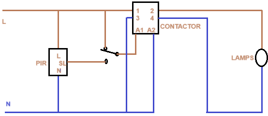

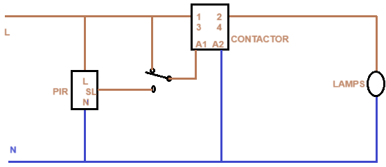

I hope i can get some help in installing a contactor for some flood lights in my garden
2 pole contactor terminals 1 and 3 top 2 and 4 bottom and a1 and a2
PIR sensor
single two way switch ( L1, L2 and common) to put in sensor mode or permanently on
cable from the bank of LED floodlights
much appreciated
Can also be double pole switched.
Do you need to use a contactor, what power of floodlights are being used?
