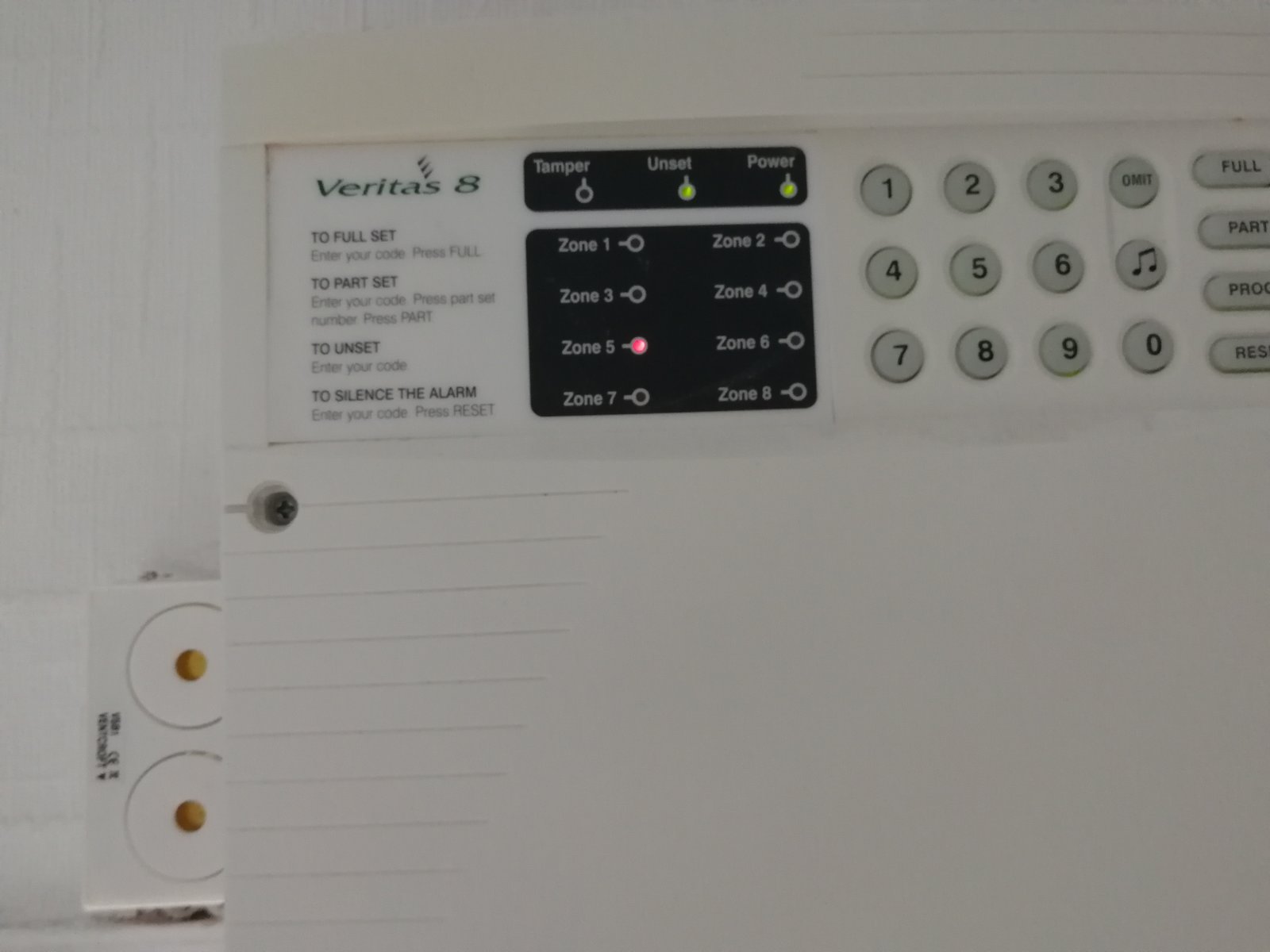

What zone number is lit on keypad.
If unsure post photo of control panel wire and will tell you where to put link.

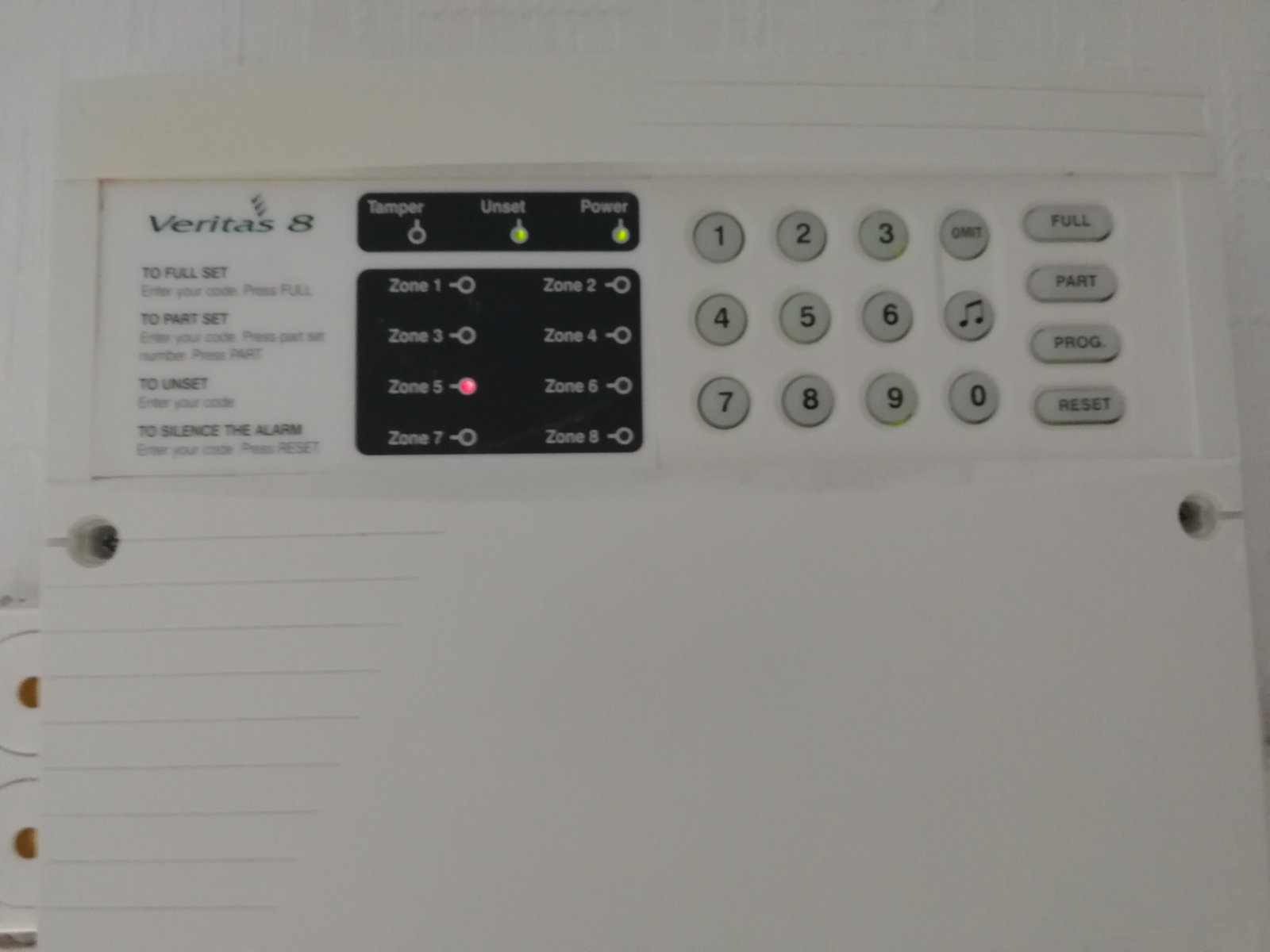

Firstly the zone lights and beeping should be in sync.
ie, zone one illuminated beeps once
Zone 1 and 5 illuminated it beeps 5 times
Zone 8 illuminated it beeps 8 times
Tamper beeps 9 times
power fault 10 times (unset light flashing)
if the back battery is old then disconnect it and use mains only and you should be able to get into the menus from the keypad.
without seeing which lights are illuminated relying on your counting and its easy to miscount.
before starting press RESET TWICE, this should get you to day mode.
then look at what the panels doing post a picture
we can advise from there as what to do next.

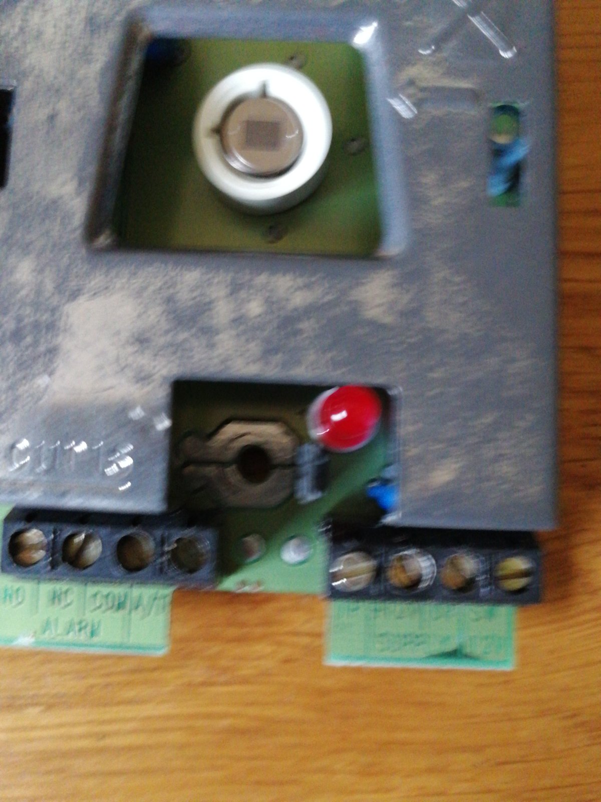

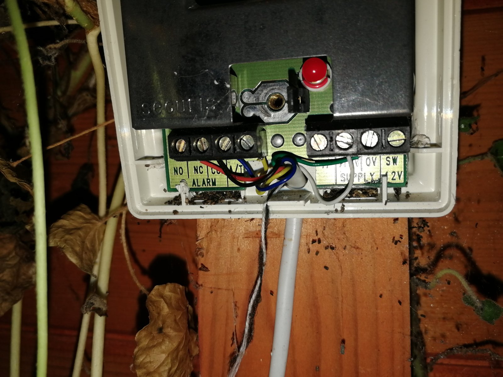

Sorry to be so late in responding, family probs. Since my last post I had a further look at the pir in the garage and discovered that some of my wifes garden had decided to infiltrate the pir. No probs thought I, easy peasy disconnect and fit a replacement. After checking on line I found I could not get a like for like,it was a Securis D20 made in Spain about 15 years ago.The Securis has 8 terminals with 6 wires . After checking on line the wiring seems different in that the green and white cables in the Securis seem to go to the supply. Surely this cant be right.
I have attached a couple of pics of the wiring as was and a pic of the board display as requested
Any advice gratefully received.

the black and red wires are used for the zone, so twist them together and you should be able to set.
clean the area down and replace the PIR (be wary of false alarms mind).
you need to isolate the white and green wires as if they are shorted it will blow the panels fuse(if glass fuses), if the ceramic fuses they will reset when the power isn't shorted.
That securis is older than you think ....we used to fit them in the late 80s and they where rubbish ...not seen any since mid 90s and they where made here ! Not in Spain ...
