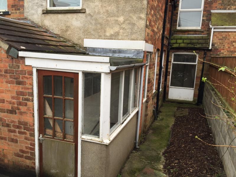

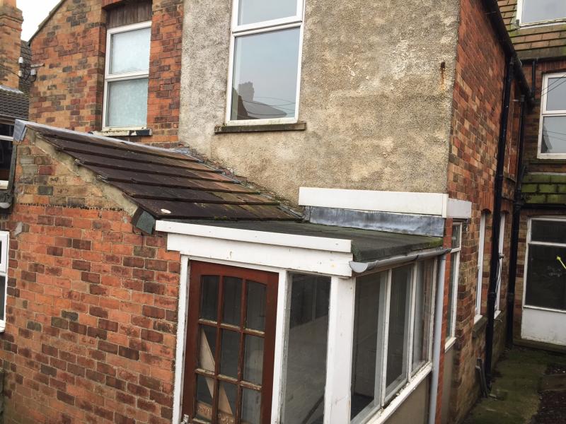

We have a single storey, single skin brick built extension that was added a long time ago (well before we had anything to do with the property). It's effectively a bit of a corridor to incorporate the original outside sh1thouse into the main property. It's not used at the moment and a bit grotty.
We're going to be removing the internal dividing walls to make an additional small bedroom on the ground for of about 11' x 7'
Currently, it looks like this:
