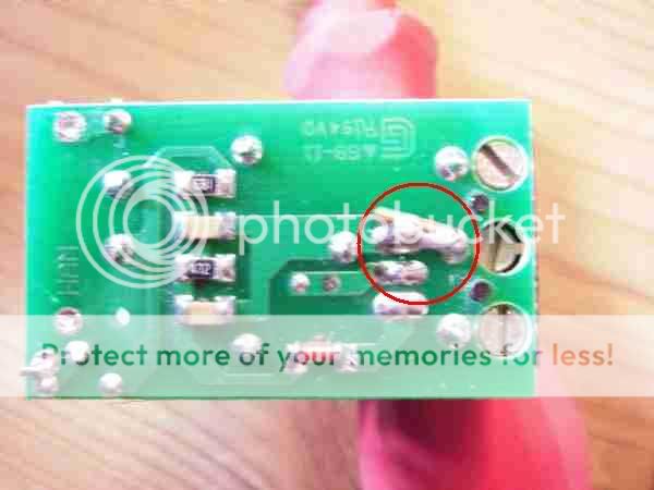

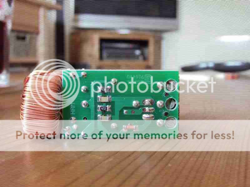

I have a 'Hamilton Litestat' push on/off, twist to dim, dimmer fitted. I cant find a suitable on/off replacement for it. (brass 3 gang, double backplate)
Is it possible to adjust something on this unit (pictured) to remove dimming ability?

You could probably bypass the dimming circuit (difficult to tell without having the physical thing to look at), but it'd be easier and safer to just buy a replacement on/off flavour switch:

However, in the mean time I modified it. After testing with my Fluke.
The 'link' in the red circle, takes the switch output straight back to the next terminal. :D
I've modified a dimmer before like this. Just a bit of solder and you're sorted.
