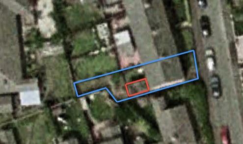

Just starting to look at options for an extension with a friend - it's really only at the "what can we do" stage so far.
It's a 1960s end of terrace, with not a lot of room, and the extension would be close (~1m) to the side boundary with the semi bungalow next door. There is an existing outhouse attached to the house, which as far as I can make out was built at the same time - it's on the 68/69 OS map, along with those of the neighbours, and the houses weren't on the 50-something map. The intention is to replace the outhouse, something like 2.5m wide and perhaps 4m long, possibly making it a little wider (at the same width, the current kitchen doesn't really allow for two people to pass easily !)
She's just looking at a single storey for larger kitchen and downstairs loo. I'm thinking there's scope for a larger bathroom upstairs and more storage.
The plot is outlined in blue, the outhouse in red in this plan. North is up.

Not quite. What I had in mind is very, very nearly within PD limits for a 2 storey extension - 3m to eaves, 4m to ridge, etc. But for a 2 storey there's a limitation of 7m from the rear face to a boundary. If it were the next house along that would be fine, there's more than 7 m to the back of the garden - but there's a "corner cut out" that's the back of the neighbours garden and that's only a couple of m away.
