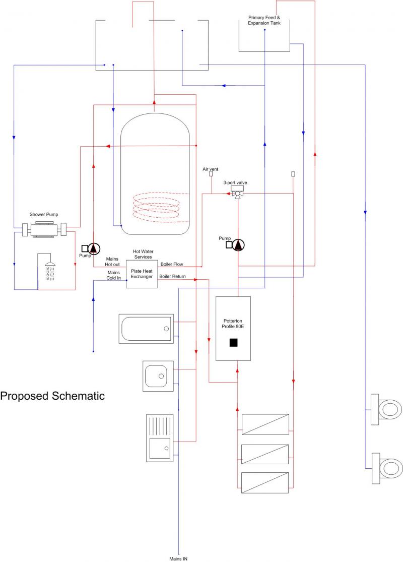

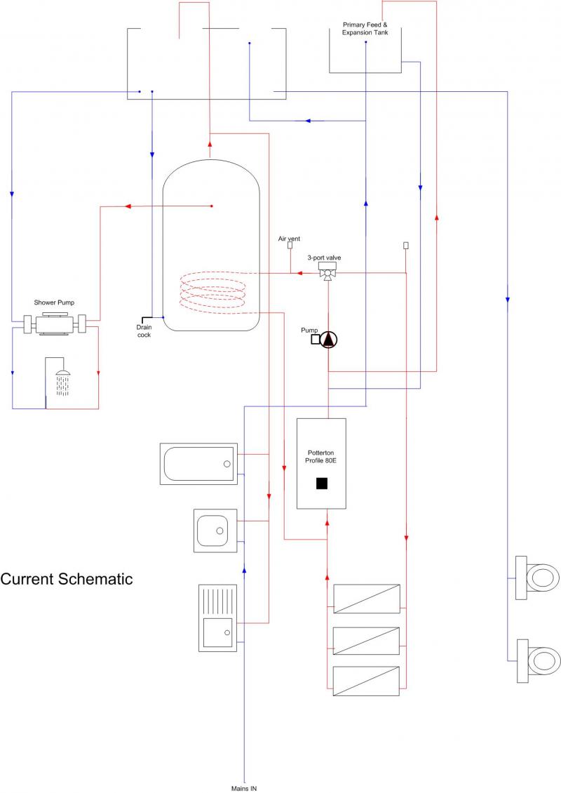

I have a standard Y plan central heating system with a vented indirect water cylinder. The current coil doesn't heat the water quickly so I was looking to replace the coil with a plate heat exchanger.
This is my current setup:

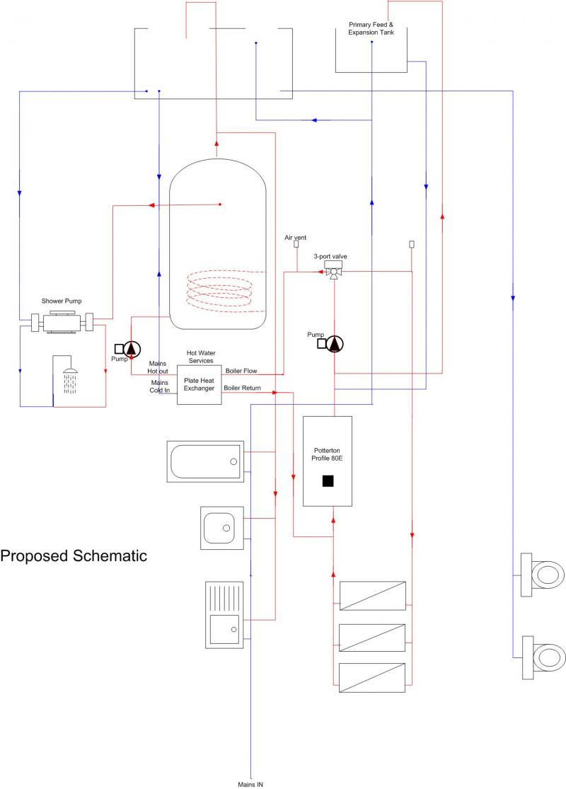

what I was looking to do is the following:
Is it possible to do this?
Can someone explain how I could reconfigure my current system to allow me to have a configuration for instant hot showers without having to replace my current boiler?
I found this link which is very close to what I would like but I can't see how to apply this to my setup.
http://www.diynot.com/forums/viewtopic.php?t=75050&start=15
Any help would be most appreciated.
