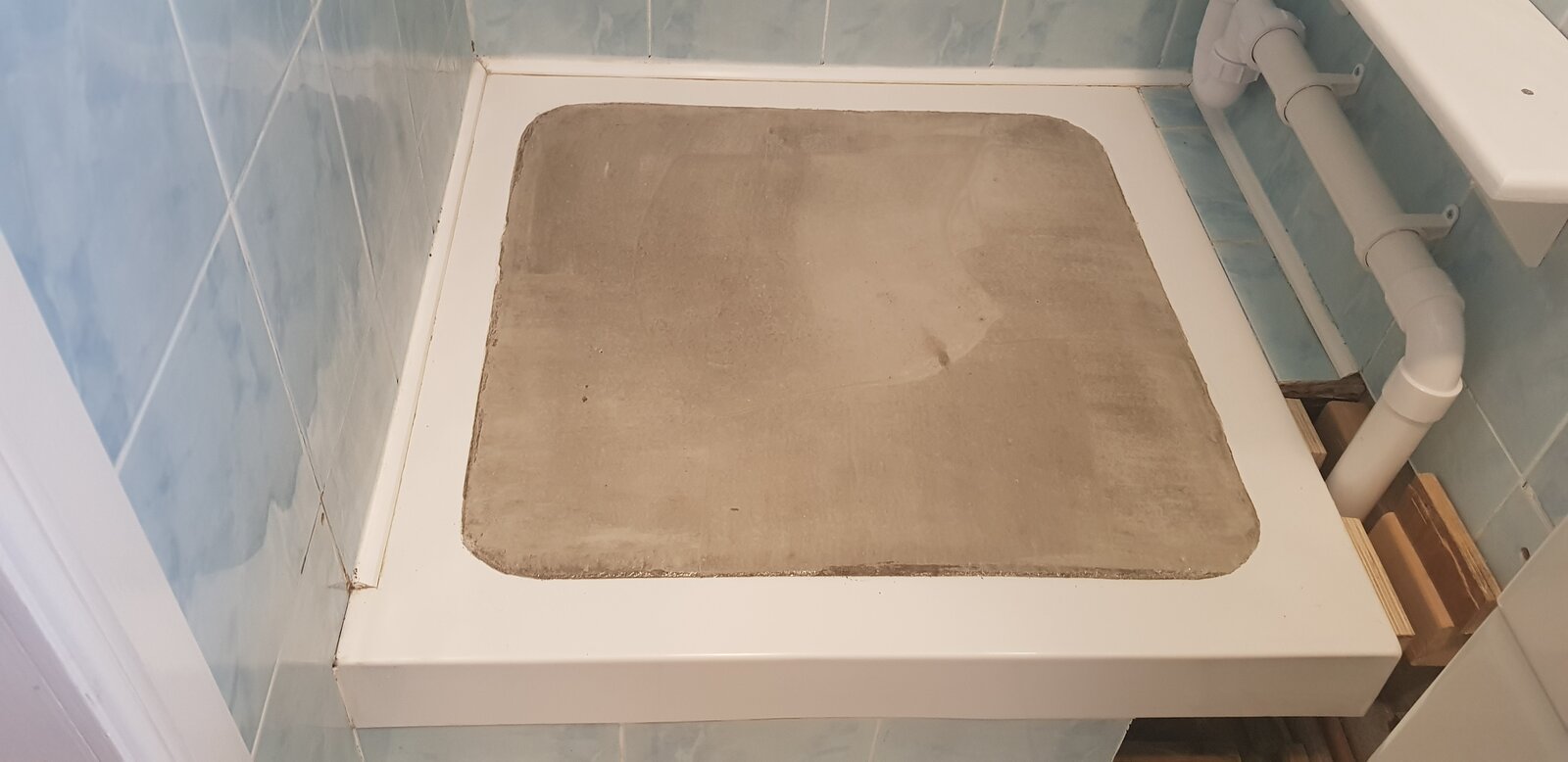

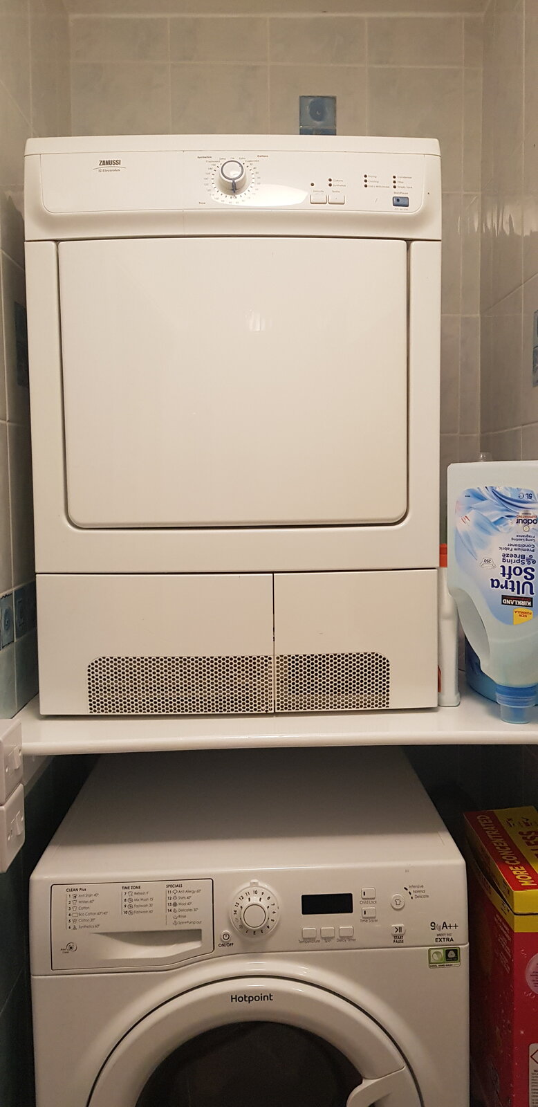

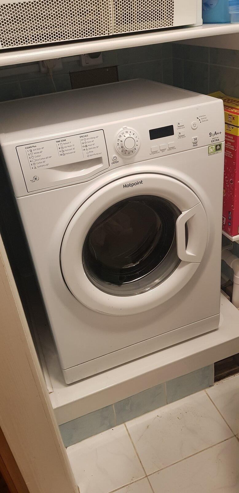

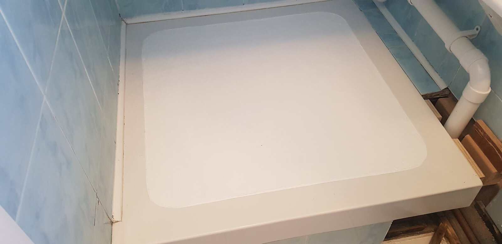

Here I am for updates.
Filled the tray with concrete and thrown some fibreglass in the mix (the fine stuff they sell in 1 kg bag.)
Tried and tested for a good couple of weeks.
The machine doesn't move at all and everything worked out perfectly.
The boss is happy that she doesn't need to squat to the floor on her ageing knees to load and unload it.
Look at the pictures.
