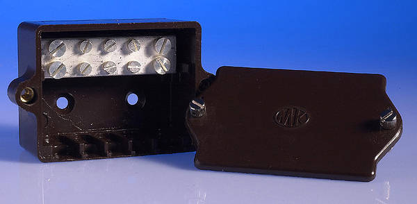

Guys, so long as the Spur (FCU) is within VISUAL distance, or no more than 300mm of the originating device, it can be fed in cable commensurate to the outgoing load.
IE..you can run 1.5 or 2.5 from the output side of the switches concerned so long as the FCU is within 300mm of the switch.
Also, with regards to large capacity junction boxes, have none of you ever heard of Henley Blocks?
For those outside the trade, many people call these SERVICE CONNECTION UNITS/JUNCTION BOXES
I tried to get a picture for you but WT Henley (formerly GEC Henley) don't a have a picture on their website of one!!
Just go into a wholesaler and ask for a 100A Double Pole Henley Block..they'll know what you mean..failing that call it a service connector.
