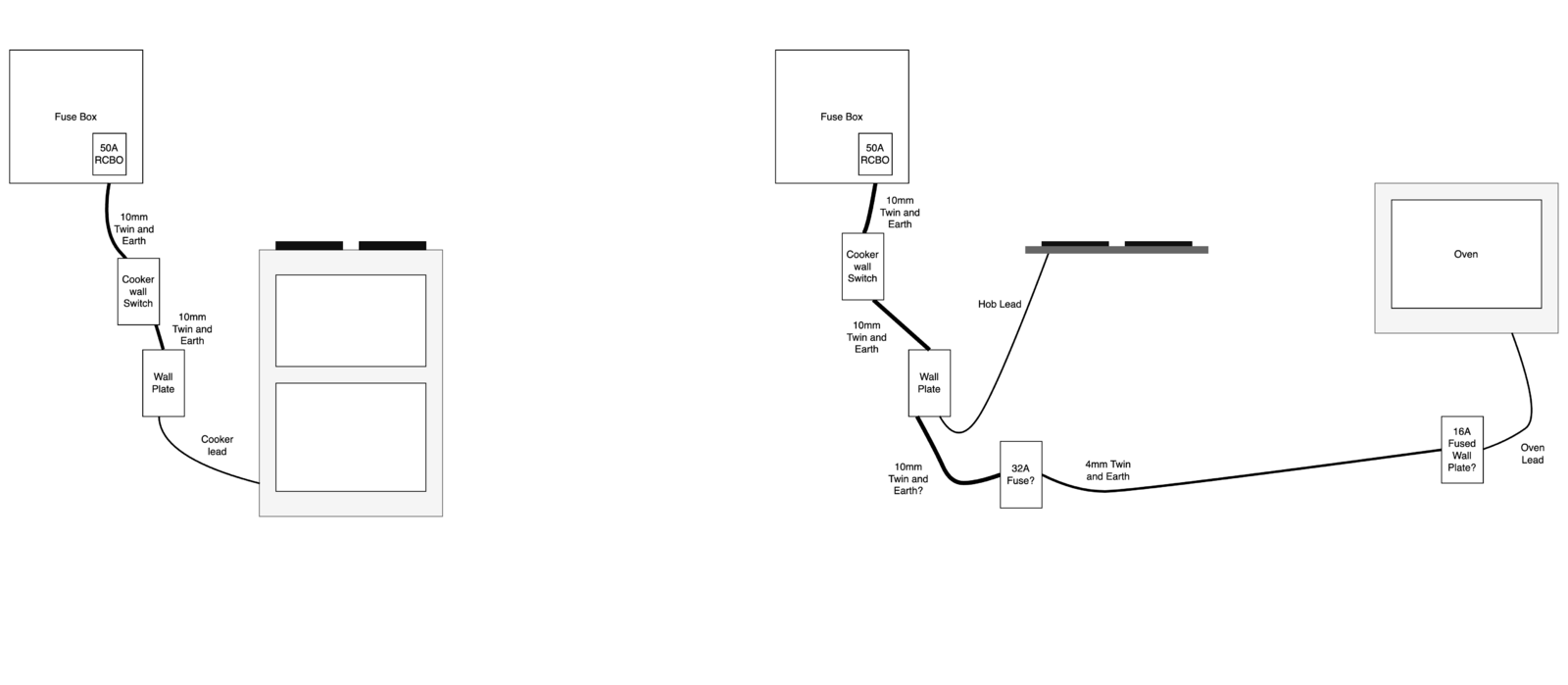

Appreciate I'll be getting an electrician in to do this but looking to understand what I'll be asking them to do.
We currently have a standard electric cooker (hob and oven in one freestanding unit). It connects to an outlet on the wall behind it via a simple, unswitched, twin outlet wall plate. The wiring back to the fuse box from the wall plate is 10mm twin and earth via the cooker switch in the wall and is protected by a 50A RCBO. Oven is connected directly to the wall plate with no other in-line fuse. I'm assuming this is normal and safe (though I wonder what is protecting the cooker cable before it gets to the fuse inside the cooker).
In our new kitchen, we're going ot have a built in hob in the same location as the existing cooker and a built in oven about 2m away in a tall cupboard. Oven requires 16A. Total current for hob and oven is well within the 10mm cable capacity (and also below the 50A RCBO limit).
To build in a bit of future flexibility (maybe add a microwave above/below oven later on), I was thinking to ask for a 4mm twin and earth spur from the original cooker outlet plate over to a new/second outlet plate for the oven. I'm assuming this would need to be fused locally to the main outlet plate (at level appropriate for the 4mm cable spur) and then again at the new outlet for the oven?
Attempt yo draw it all out below:
Thanks.

The RCBO is protecting the cable.
It is unlikely there is a fuse inside the cooker.
Any domestic appliances you are likely to buy will be well within the cable capacity.
32A RCBO and 4mm² (installed Method C) is all that is required.
You have all the future flexibility you will ever need.
10mm² is often used as the main supply cable to flats.
You could just reduce the rating of the RCBO to 32A.
Nothing locally would be required.
Nope.
Nope.
Jeez, I see what you mean. If I'm doing my diversity calc correctly I should only ever need ~26A
Hob = 32A
Oven = 16A
Micro/combi/whatever = 16A
Total = 64A
So, ((64A - 10A) * 30%) +10A = 26.2A
Is that right? In that case, the 32A RCBO makes sense even if I were to add a full second oven further down the line. Seems almost too easy :)
Thanks again.

That is correct.
Yep.
Also the add on extension is less than 3 meters, so that supports not requiring additional protection.
Where does the 3m come from? You are surely not misreading 433.2.2 as another here frequently does?
So you could almost use whatever cable you want! 4mm or more common and future proof 6mm.
The use of 6mm² would more correctly be called "past proofing" as it was/is required with a BS3036 30A fuse but not a 32A MCB/RCBO.
A lot of sparks would put a 32 amp radial circuit in using 4mm but wont use 4mm for a 32 amp cooker circuit.....strange that
Thanks for all the input on this. Really helpful. Sounds like I'm just asking for a 6mm spur from the original outlet plate. Nice and easy.
