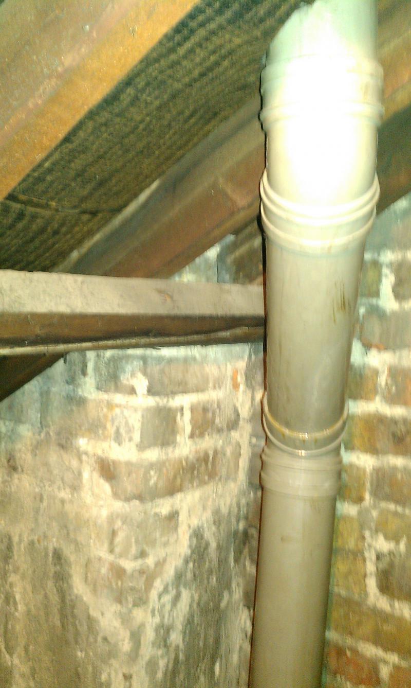

After crawling around in the loft and hanging out my kitchen window on the 2nd floor, I think there's no room to fit a vent out of the soffit since there isn't really one!
Does anyone know how much it would cost for a tradesman just to simply install a vent out of the roof tiles?
There are two other options which is to have a suspended galvanised duct across the kitchen ceiling (might look nice) and out through the existing wall extractor [after removing that, it's rubbish anyway) or joining the duct to the existing one in the loft [See photo] which goes through the roof. This duct seems to be for the bathroom extractor fan and possibly not just for my bathroom but the flat below too. Is it viable and simply a matter of cutting and joining into it or do I need to other stuff like a condensation trap?
Here is a photo of it:
