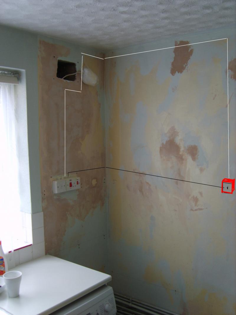

If I were to transfer the socket to the RH side on the adjacent wall and create a horizontal chase in the plaster at the same height as the original socket, ie about 1300mm from the floor, would that be in the 'safe wall zone'?
Safe zones do not go around corners, so, if I understand you correctly, the part of the chase behind the cooker would not be in a safe zone unless there were some visible accessory (on the same horizontal line) behind the cooker. However, I presume that you would have to join the cables behind the cooker. If you did that in the existing back box, with a blank plate on it, that would create the necessary safe zone and I would have thought would also be acceptable to gas installers - even though you might not find it aesthetically ideal..
If not, it would have the create the chase in the hard wall up to the ceiling, across it, and down again.
The same issue would arise - you would need some visible 'accessory' (like the blank plate mentioned above) to create the vertical safe zone for the cable up to the ceiling.

Since the walls are made of solid brick covered with plaster 15mm thick, would I be able to create a chase in the wall, and then bury the cables in plaster for aesthetic reasons?
I have added an additional pic where the black lines would be a chase in the plaster with cables, probably the easiest option. If not, perhaps by creating a chase vertically, along the ceiling then down again (white lines). The red box I have coloured would be the switched FCU for the extractor fan. Could I do that?
Finally, another idea I was thinking was to move the switched FCU about 800mm above the cooker, blank off the Cooker Switch and then fit a socket behind the cooker. The cables would again be buried in plaster. Would that be allowed?

You may not have that dogleg in the white route at the top.
You may not have the one in the black route where it comes out of the existing switch.
http://www.diynot.com/wiki/electrics:walls
Chasing would have to go into the brick, not just the plaster, or you'll not have enough plaster depth over the cable to avoid cracking.
