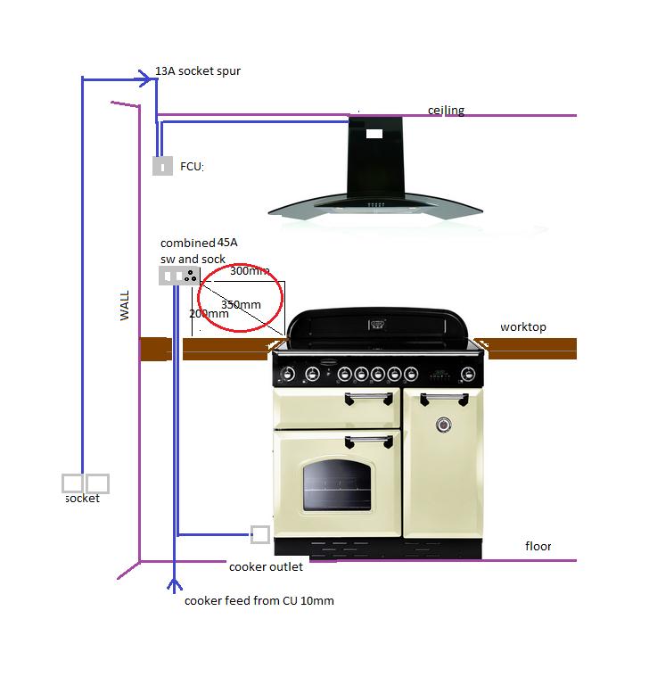

Hi all - I have had electricians in to do most of the electrical work in an extension but as I am struggling with budgets I am doing the wiring for cooker and hood. I will get a qualified electrician to do final connections.
I feel confident about most of my routing but am worried about locating the cooker and hood switch under a worktop. They will still be visible and accessible when a unit door is opened. Can anybody reassure me that this is legit? I only have 400mm worktop to the left of the cooker - just enough for a single socket!
Many thanks.

They ideally need to be accessible without moving tins of beans etc.
As spark123 said, it's best if their easily accessible. Mine oven isolator is located behind a draw what has to be pulled out and removed to access what is not ideal, but where it was placed. (All floor to ceiling cupboards across whole wall.)

Thanks spark123 and eveares - got the idea. The wall is actually an open old stud frame. I can get around the back and move the under worktop bits to there. Electrician away on hols spending my money!

There are plenty of cooker switches hidden away like that, but the proper place is above the worktop so it can be seen and accessed easily.
Pointless having the FCU for the extractor under the worktop.

Don't like it hidden away from from view. But according to a consultant I spoke to in November its ok because its for isolation and not emergency switching. Not sure what one is meant to do in the event of a chip pan fire then!
Personally, I think he had just given up arguing with architects and kitchen designers!
That is completely the wrong way round.
They are not required for isolation so - if you consider one necessary for emergency switching, then, obviously, it should be readily accessible.

You must, must, must make sure your electrician is OK with this.
Which means he is the only one who can answer your questions and tell you what to do, which means that if he is on holiday you will have to wait - there is no alternative.
You cannot expect him to sign an EIC saying that he did the design if he didn't actually do it.
And then there's certification of Building Regulations compliance - when you applied for approval, what did you say, or allow to be said on your behalf, or by default tacitly accept, would be the way that you'd ensure the electrical work would comply with the Building Regulations? If you do something different to that, and as a result find you cannot get a Building Regulations completion certificate your current budget problems will seem like happy days.

Back to plan A but with all your suggestions (much appreciated). My only worry now is closeness of cooker switch/socket to hob. I have read that 300mm is the minimum allowed. Does anybody feel that they are too close? - they could go a little higher?

I would be alright with that; the 300mm. is only a recommendation.
To save all that chasing from the socket, do as I suggested and supply the FCU from the cooker switch.
Thank you EFLImpudence - will do. The cooker hood has a couple of 40w bulbs and motor power is less than 200w so extra load should not add much load.

you can run a cooker hood off a lighting circuit.
