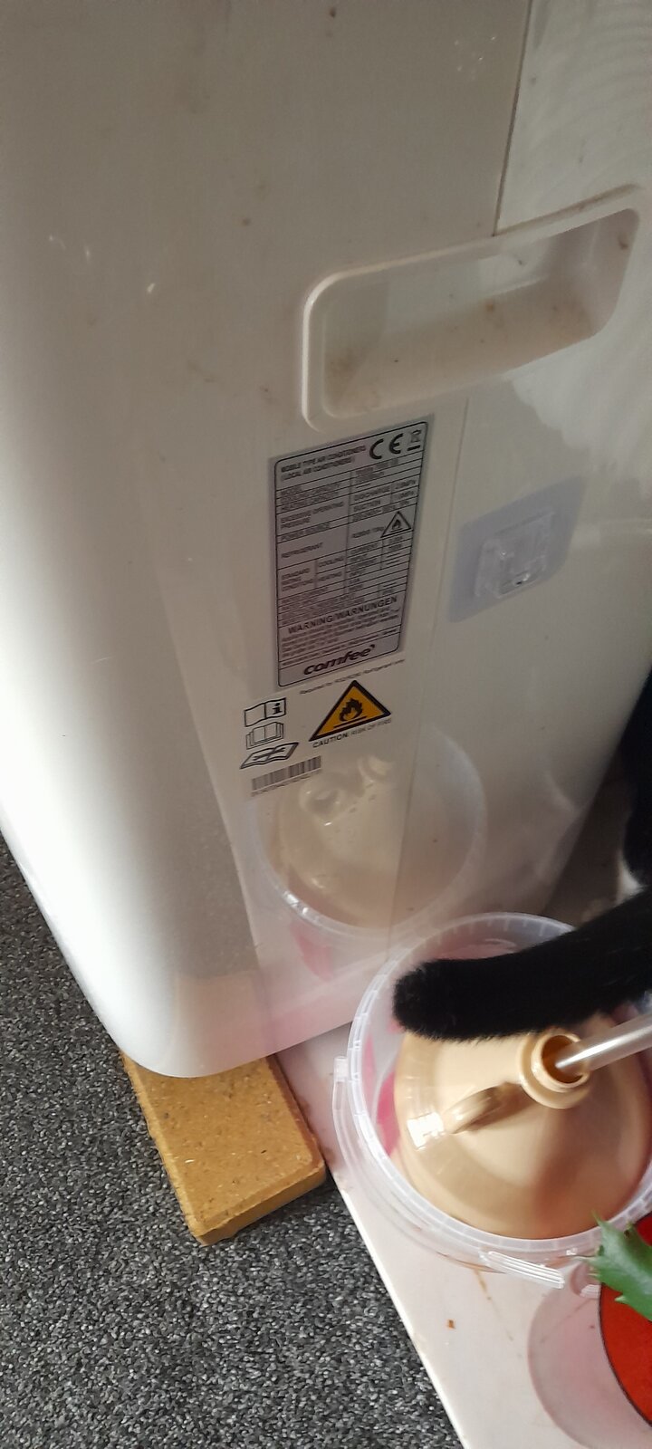

I still flung open the patio doors this morning (7:30 am), and allowed the room to cool, closed again at 10 am. No real need, as been a cool day. Biggest problem is to remember to empty the condensate from the AC.
perhaps a soakaway would be able to deal with the volume of moisture generated, but you can also get effective service from arranging an automatic siphon to occur, as a relatively small bore pipe with reasonable height differential will flow quickly and keep itself clear. If the AC unit water tank holds say 10cm of water, drill a hole in it at 8cm up, and install a snug fitting, small, flexible pipe such that it picks up from the bottom corner of the tank. Now when the AC fills the tank to fractionally above the 8cm mark, the siphon will start, empty the tank then stop.
1748686454204.jpeg Condensate tank (old cider bottle) in a sweet box so if it does over flow, I can both see, and it stops floor getting wet, also bit of cats tail. Since starting thread, AC has not run, and in general we are looking at maybe 4 weeks a year, where required, so not going to great lengths to get rid of condensate.

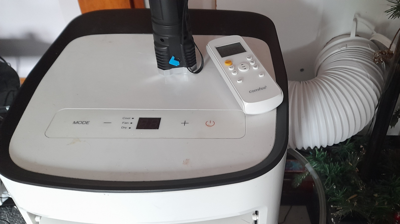

1748686938273.png The pipe into the chimney works well, no windows open, so house secure, and since fire has never been used since I have moved in, it also seals the chimney in winter, but easy enough to remove should central heating fail.
But I still look at other methods. The room is a bit too big for the portable AC unit, it can maintain the temperature, but if allowed to warm up, not really good enough to cool it again. Since it also reduces humidity it makes the room seem even cooler.
