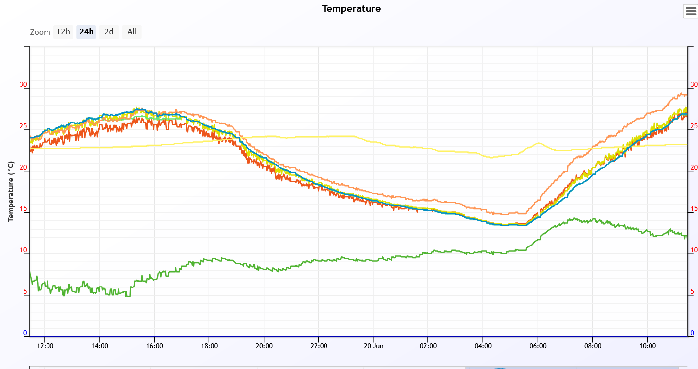

I cool the house fabric down, during the night, aim to restrict solar gain during the day. During the night, front bedroom window(s) are flung wide, along with rear window(s), to take advantage of cooler night air, to cool the house fabric down. During the day, we close blinds, to bounce heat back out, all windows are closed, we just have the back door open, which has a permanent for the summer fly screen up. My routine works for several days, even in the worst of the heat, to keep the house a few degrees cooler than outdoors.

This is our situation, this morning... Yellow is the indoor temperature, blue the outdoor- it is already 27.1C out there. We've had two bedroom windows wide at the front, bathroom window wide over-night, now closed, as are blinds on the sun facing side. You can see a dive in indoor temperature, when the windows are opened at 11pm last evening. The dive in indoor temperature, wasn't as pronounced as usual, because there was absolutely no breeze through the house.
Opening the loft hatch, will not be very effective, unless the rising air has somewhere to escape, once it rises into the loft. A well sealed uninsulated roof, the temperature up there could easily be 50C. Open the loft, and warmth from the house, will rise into the loft, initially causing that 50C air to drop into the house, the opposite effect to that required. A well insulated roof, with some sort of open, opening window up there, can be very effective.
