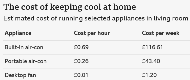

The "portable aircon" has to run at 1kW (approx 26p/kWh) but 24 hours for the full 7 days to get to £43.40
Stupid, stupid ignorant lazy Journalism by an illiterate. OR Arificial Ignorance.
NB Those numbers are, BBC states, from USwitch data... so not sure who is the more stupid as neither have 'sanity checked' the numbers, and that took me all of 60 seconds (if that).

just lazy jurno : uswitch actually state :
DeviceAv. minutes used per weekCost per hour/cycleCost per week per householdCost per year per household
Amp171.5£0.04£0.11£5.74
Built-in air con system204£0.70£2.36£122.82
Bit of a difference... still it is the beeb
