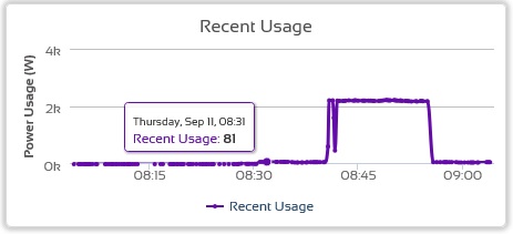

I find most items have wattage marked on them. But the tumble dryer is a leap of faith, I have used an energy meter, and once the drum is warm enough the heat pump uses a mark/space ratio to control the temperature, so although it runs for 2.5 hours, and uses 650 watt when the heat pump is running, it is not a simple 2.5 x 0.650 to give the kWh used.
The dishwasher is the same, Start recent usage.jpg once the water is hot, the power used drops off, but if there is a dry part of the cycle, then that also uses power at the end.
The dry cycle also drys out the dishwasher its self, so reduces the problem of water in the dishwashers electrics, so saying the dishes don't need drying is not quite true.

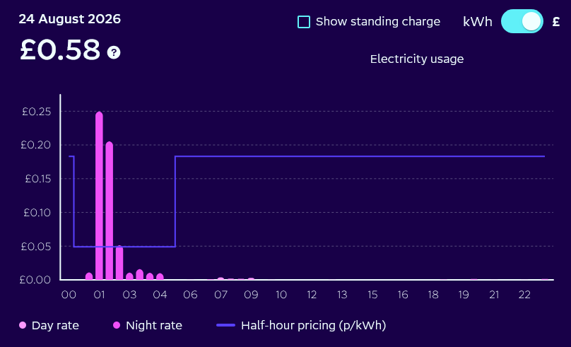

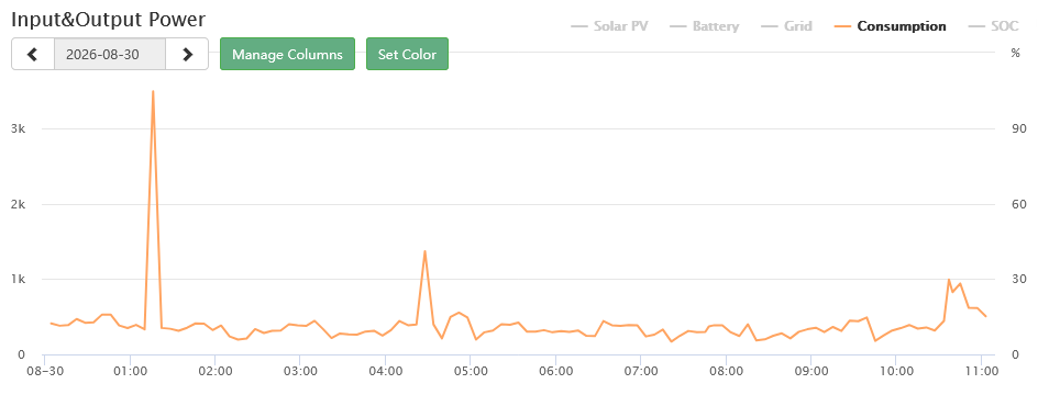

I look at my consumption 1788086071649.png but as to how seeing it helps reduce it? As to a smart meter how does this help?
1788086435268.png So I charge the battery with off-peak, and rest of day, nothing, and at 58p am I really worried how much I am using? £1.28 with the standing charge. Or -£1.52 in total when export taken into account.
