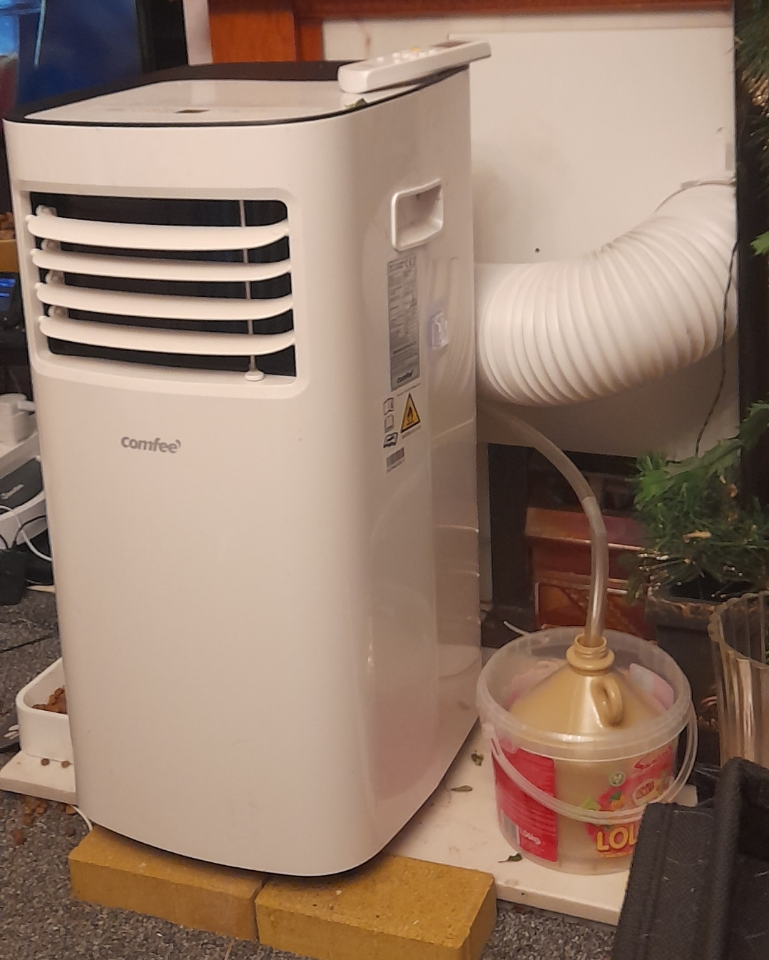

Typical "portable ACs" with a single flexible hose are inefficient for serveral reasons.
Agreed, I use this method 1756760045822.png with the tube up the chimney, but this should show more not less cost using portable to fixed AC's.
I looked at mine, in 755 watts, out 900 watts, and to be frank most of the power seems to be in running the fans. It will keep the room cool, but if room allowed to heat up, not really good enough to cool it again.
