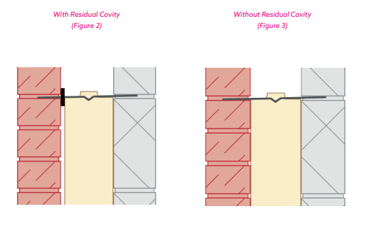

and if you knew how to calculate U values, your current project could have been delivered with a saving of space and money, to the client, with a minor tweak to the specification.
110mm celotex replacing 50mm air + 100mm celotex.
It won't for example pass through 103mm of brick, 50mm air gap, 100mm of Celotex, 100mm block and 25mm of dabbed plasterboard so long as you've got a hole up your arse.
We have to use a certain product with full fill PIR. It's actually 90mm (10mm fitting gap) with rebated edges and coated against the wet side etc.
An absolute b'stard to fit up a gable with stepped cav trays etc.
Some builders fit one row of boards and lift it up with each row of bricks as they go
Is the gap so that you can fit the retaining disc?
