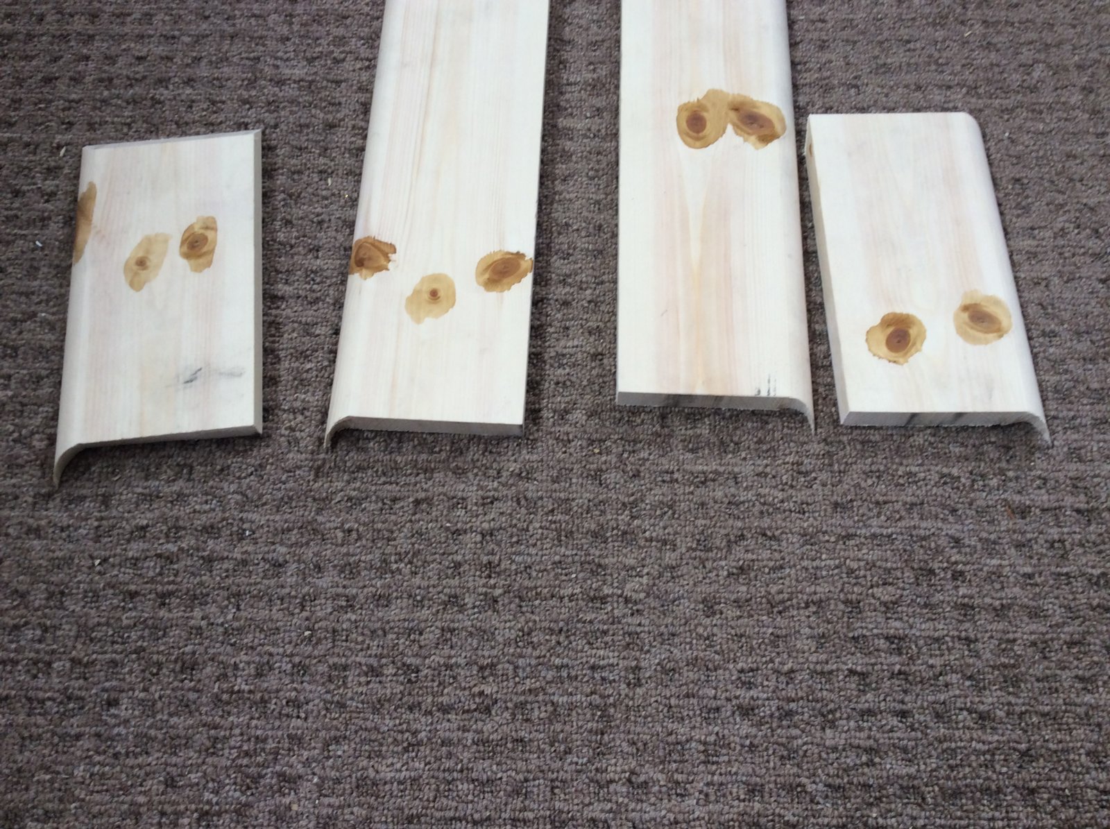

I need to install white chamfered skirting in a bedroom. I’ve seen videos describing coped corners as well as a mitred cut once you’ve established the corner angle.
I have a mitre saw and a bevel (and coping saw!). My corners are definitely not 90 degrees.
I’ve never done skirting before. Can you suggest an approach please.
I mentioned that I’ve seen several videos. Interested in your views as it’s a first for me. I also have a bevel and mitre saw and wondering if the non-coped version may be more suitable on this occasion?
inst scribe the method that involves the coping saw to cut out the "curved" part of the skirting?
It's just different terminology - "coping" is an Americanism whereas "scribing" (scribed joint) is what a British carpenter would call it. In point of fact the easiest way to proceed is to start with a bevel cut, highlight the front edge with a pencil rubbed at the edge, then saw the straight bit with a slight undercut (chop saw, panel saw, tenon saw - whatever floats your boat) and finish the top profile with a coping saw (again with a slight undercut). If the end is offered up to the installed skirting at that point it should be possible to see what adjustments are required because you can bet your bottom dollar that whatever you're butting up to is either out of plumb or cupped in some way, possibly both (even if just ever so slightly). Which often makes minor adjustment a must - and is why you do the scribes before doing the mitres (outside corners)

Just doing some at the mo
