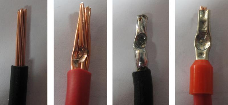

Results of termination tests:
Left to right
1) CCA cable, fresh from a strip.
2) Lightly torqued in a screw fitting, note the broken strand.
3) Soldered and torqued (NOT COMPLAINT), improved mechanical response, but still a lot of deformation.
4) Crimped with a ferrule. Improved deformation, solid looking connection.
Fubar

Re-wiring would be pretty destructive to the otherwise freshly decorated house. Cables, as far as pure conductors go, look alright. Just the termination that's a pain.
Not a fan of those crimps. I get why they're used, but at least with a ferrule, you are clamping on the wire itself, albiet, through another layer of metal.
Tempted to solder some solid copper singles to the CCA in each backbox and terminate on the singles.
Fubar

I like rising clamp connections, but the designs (cosmetically) are somewhat limited and I'd rather not replace all the sockets. Would rather have a clean way of either terminating CCA in a screw point, or converting it to full copper prior to inserting into the accessory. Is there anything wrong with the ferrule approach?

Would the ferules not act as said load distributor in this instance, or would it need to be substantially more rigid?

Cheers Flame, Is there a particular reason to prefer the pin crimps over ferules?
