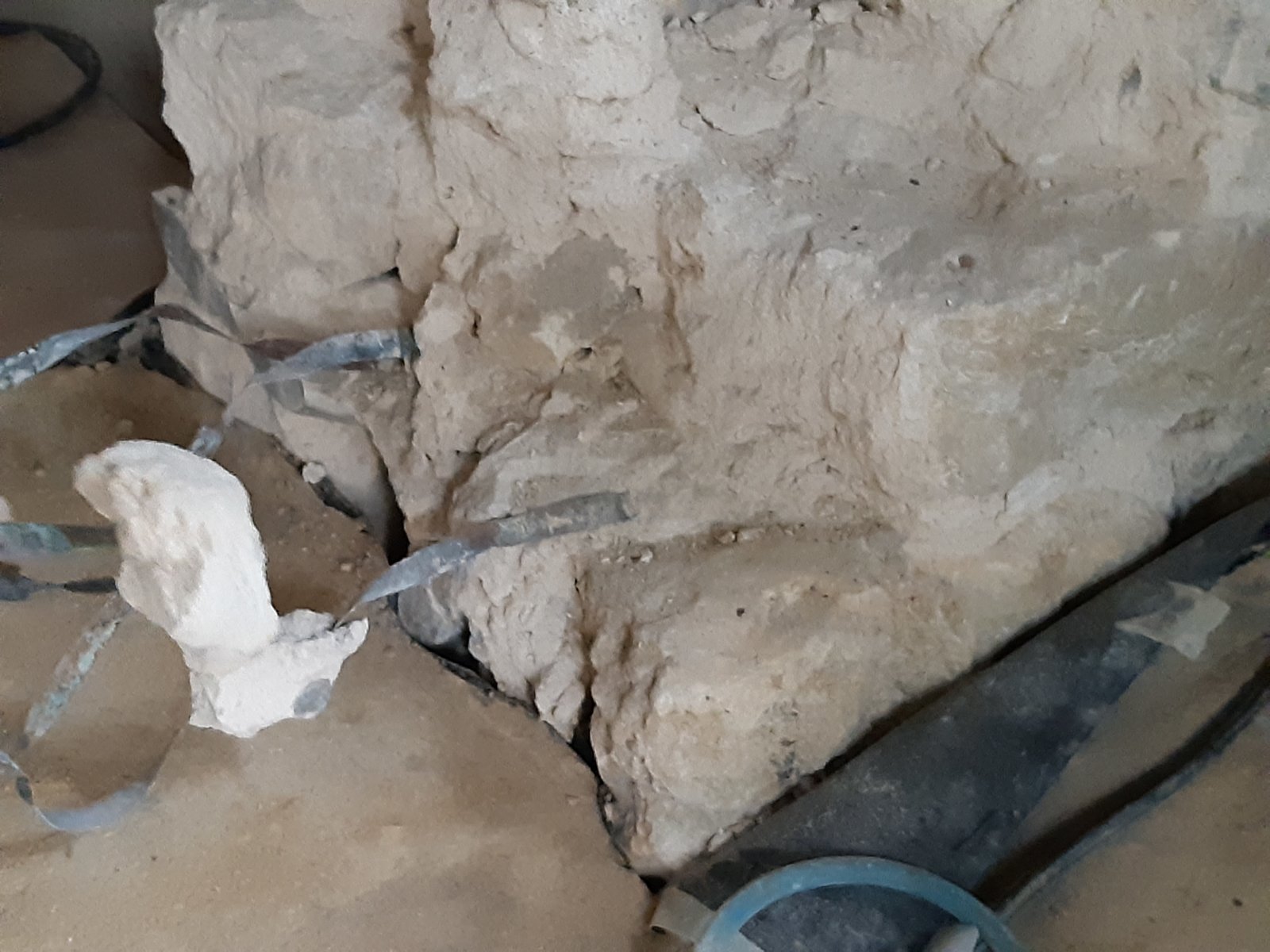

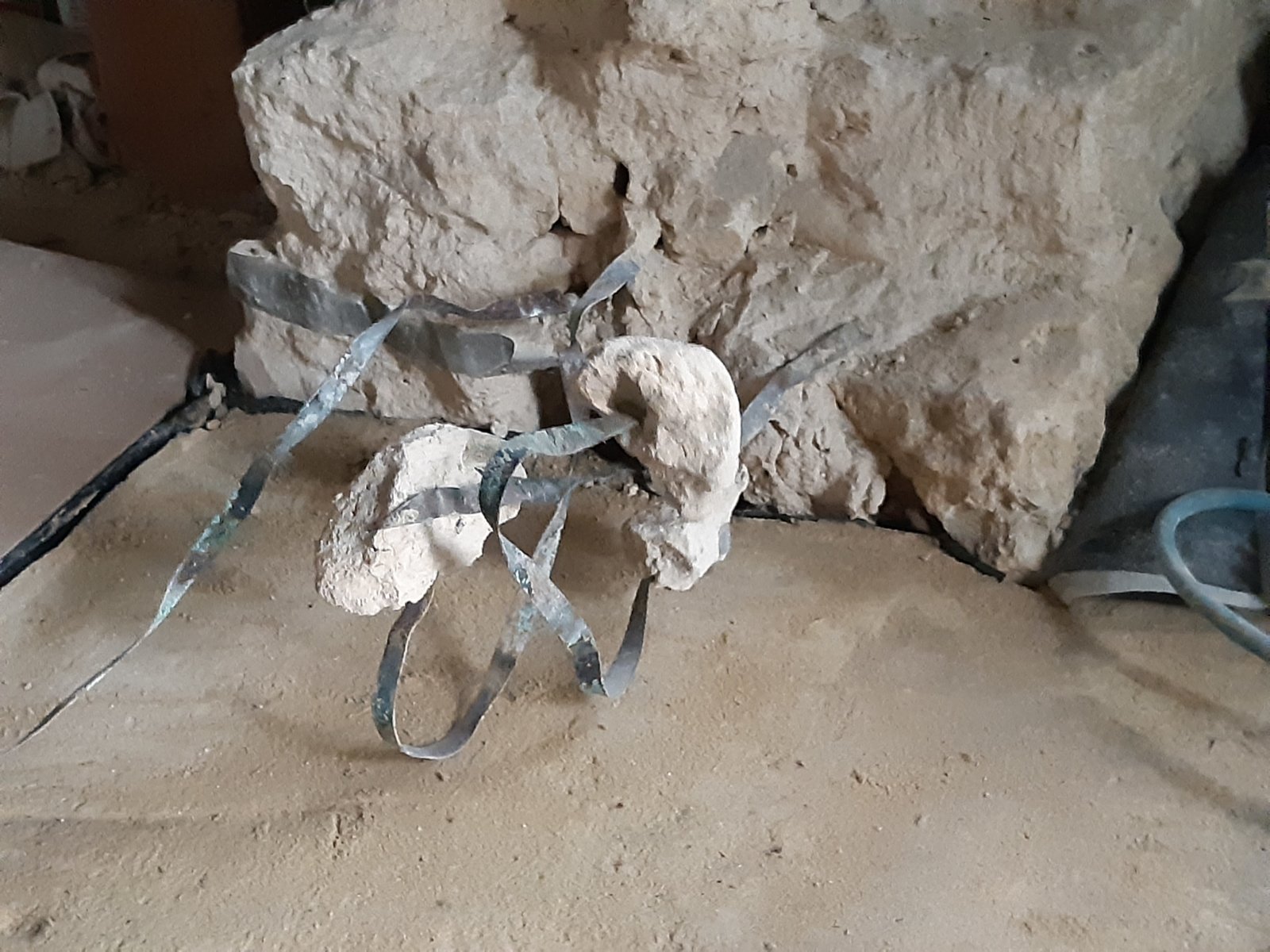

I'm just cutting a new doorway through an old solid stone wall and there are 3 copper strips running along about 2 inches off the ground level.
I presume these are some old damp proofing technique.. any ideas?
I found some references to electro-osmosis which seems a bit sketchy... just want to check that I don't need them.
yes, they are most likely osmosis strips - a rip-off from the past
no, you dont need them. just cut them wherever.

Interesting that , IIRC NHBC approved electro-osmosis for use in conversions at one time (yes, NHBC did cover conversions ) as a damp proofing treatment for existing brick walls.
I thought it was recommended for cob as well at one point. Never seen it on brick.

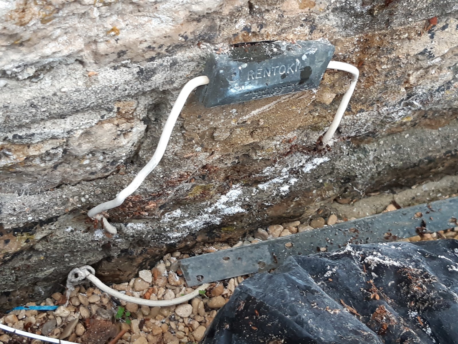

Just realised this rentokil widget on the wall outside might be something to do with it ?
