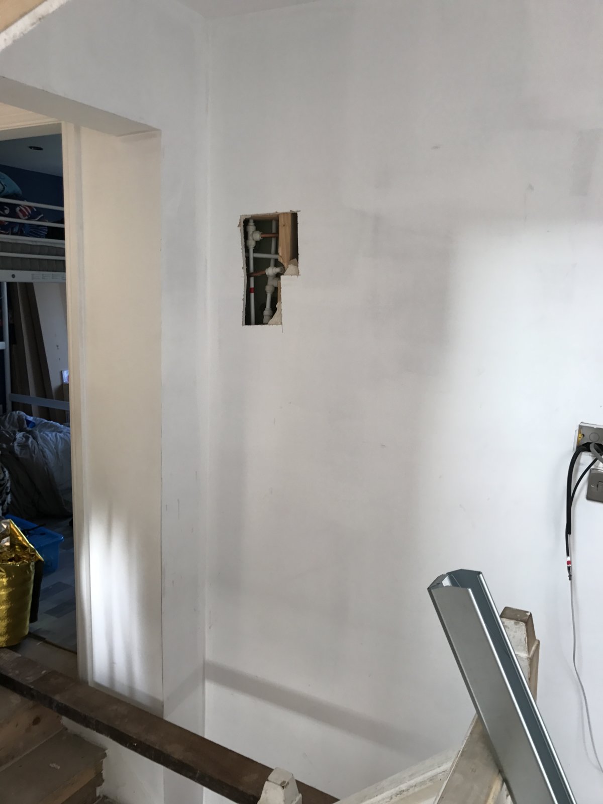

Installer error, first day in new house:
