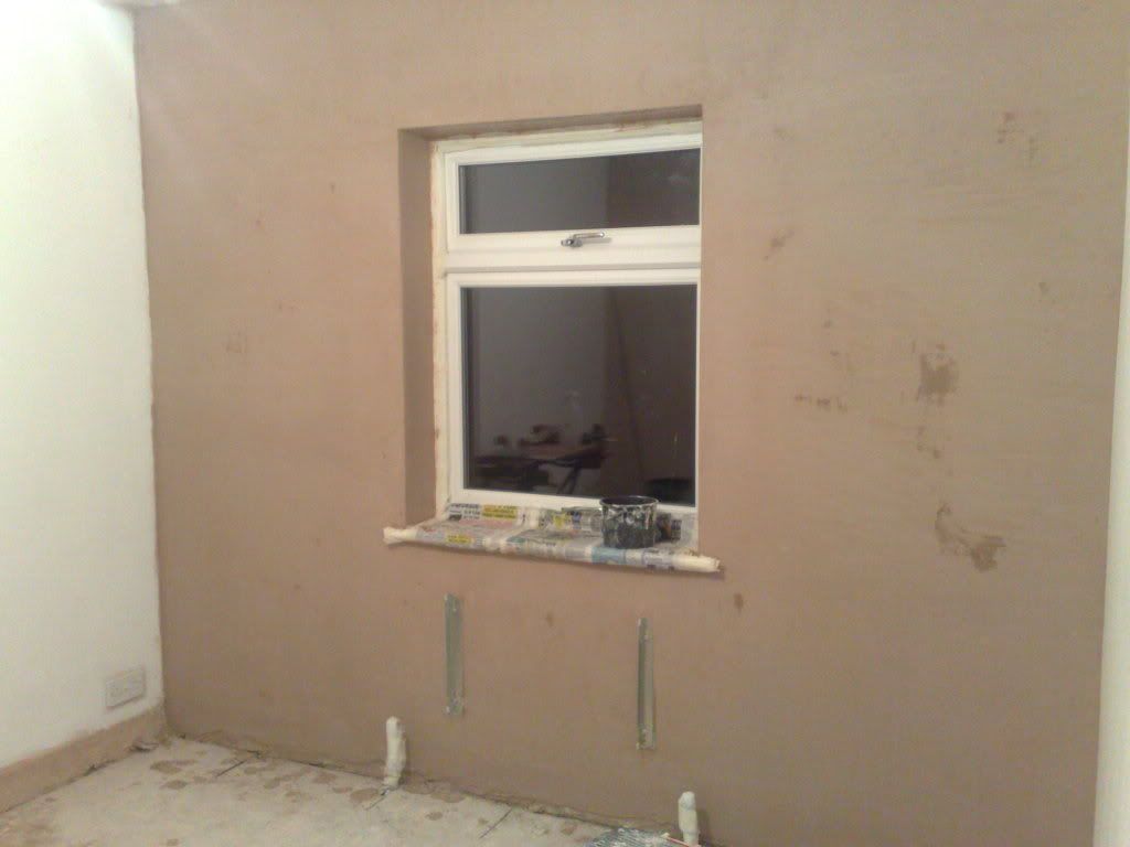

Need some advice please, i ve now got to a wall with a window recently had new windows and fitted i ve bonded up the damage to old plaster now i want to skim this wall.
I take it i will need to use angle corner beads?
If so is there a certain one i should be using ?
they are going onto old plaster can i use some multi to stick them to the wall or use the proper stuff?
If it's just a skim coat over the wall, you'll need "thin coat beading" for the window reveals. I normally (always) put them on with small headed 25mm galvanised nails, (a stronger fix), but you can bed them on with multi. If you go down the nail route,, hammer them in carefully, and angle the nail "away" from the reveal corner.
i'm with you RC, except i use only 20mm clouts, JUST enough to hold and not too much to have to hammer into brickwork too far, always worried about knocking the existing corners off :D
gripfill as an alternative though, and if the angles are out and the beads won't sit naturally tight to the edges the knock a couple of clouts JUSt in to hold them for half an hour till they set then pull 'em out.
staple gun SOMETIMES works but depends on what the substrate is.
Good tip using the staple gun TM ;) ,,,, i've not used it myself though.

Thanks guys, I got some 20mm clouts but it was cracking the old plaster so i used some multi as well.
If the clouts are cracking the old plaster would I be better off using just multi ?
Yes you would if its causing the corner to break away ,just make sure its well seated and you have an even amount the whole length of the bead and dont leave any protruding through the bead or when it goes off it will knock the bead off when you try and remove it

Thanks for the advice guys got it plastered on sunday, used a few 20mm clouts in each bead and a dab of multi left it overnight to set before plastering.
Hasn't come out to bad still a few marks to fill but best wall I've plasters so far, now completed all the walls in the room so have the ceiling to do next got a pair of stilts can wall around in them but not sure i could walk and plaster in them :eek: any tips for the ceiling would be much appreciated :)
