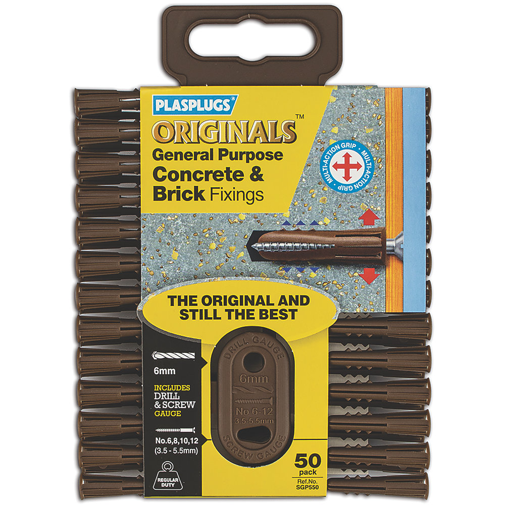

Are the plasplugs in a block, with a rectangular piece in the middle, with information and holes in it?
Example

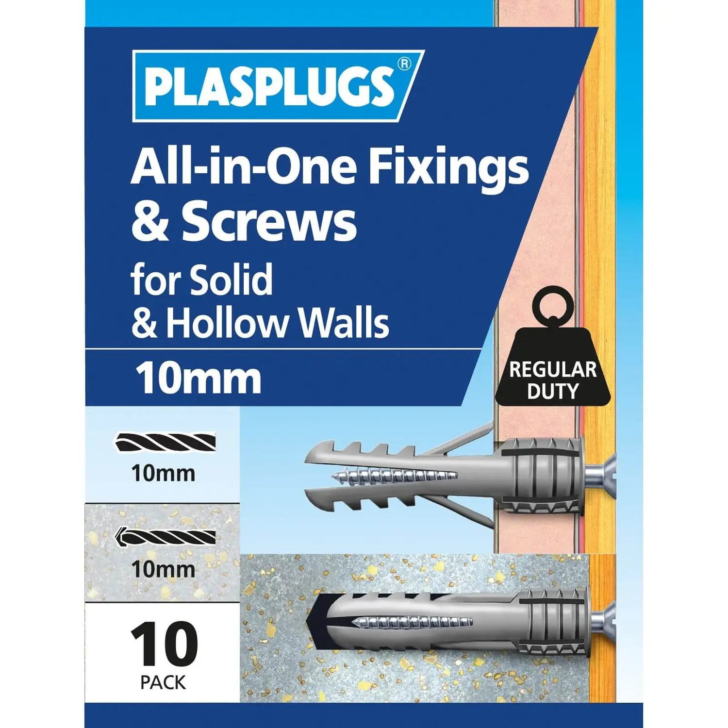

Or with a cardboard wrapper like this?
The hole has to be as deep as the plug is long, or the screw, whichever is longer. Disregard the thickness of the plaster, which has no strength. Tap the plug slightly below the surface to reduce cracking of the plaster.

To answer your questions. The house was built in 1978. The wall is 11 inches thick. Brick on the outer but from memory grey dust came out when a tv cable was installed which is why I think its blocks. Just to be clear I have never drilled it. I said I had attempted to screw into it and by that i mean without pre-drilling (like I said I don't have a scooby about this stuff hence the need to join a forum and ask!), I did not go beyond the plaster, just ended up with a bent screw and a damaged driver head. The plugs I ordered have not arrived yet so i've no idea if they will have a drill gauge on them but for the price I doubt it.

For a 10mm plug you use a 10mm drill.
Hold it straight and level. If your hole is ragged and the plug is loose, come back for other advice.

You can get screws and plugs at places like Screwfix and Toolstation. I habitually use brown plugs and No. 8 screws (4.5mm) which are ample for most DIY jobs.
Example

I ordered these:
https://www.ebay.co.uk/itm/144172643406?var=443472133521
For occasional use these drill bits are good.
