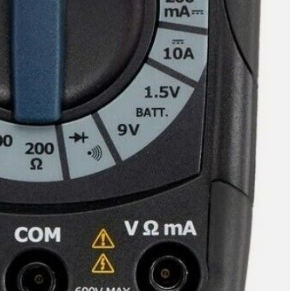

Always good to have two multimeters.... So my suggestion is this £12 Amazon multimeter has 1.5V and 9V battery tests that I have found worked well (and easier to use than trying to hold a resistor and test leads).
Unfortunately no longer for sale on Amazon. But I think old new stock being sold on eBay.
Yes the meter has a battery test 1736157444311.png but if one already has a multi-meter, then a battery tester is cheaper. Unless you know exactly what type of battery is being tested and what it is to drive, then all rather pointless.

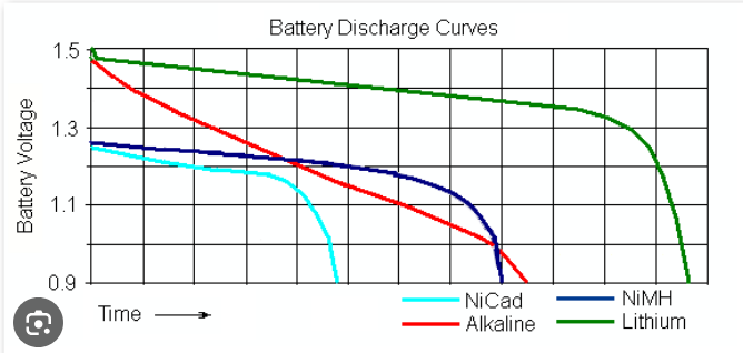

If I look at this one View attachment 368191 it says "High Capacity: 16 pack of Powerowl non-rechargeable 3000mAh 1.5V lithium AA batteries with light weight(15g/1pc)and long lifetime(10 years)." I was looking for the discharge chart, I did find a general chart View attachment 368192 and I was considering using the lithium primary cell for my cat flap, as it holds the voltage better towards end of life, and removing an alkaline battery I find loads of energy left, and they will work my mouse on the laptop with no problem long after they have failed on the cat flap.

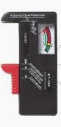

However to test a cell the easy option is use a unit designed for the job View attachment 368193I have used one of these for years, one gets to learn what to expect, although I have used a multi-meter when tester not to hand. With a multi-meter a primary cell is normally better than 1.5 volt when new, although you may still be able to use a battery showing 1.4 volt, I have found often they will not perform under load.

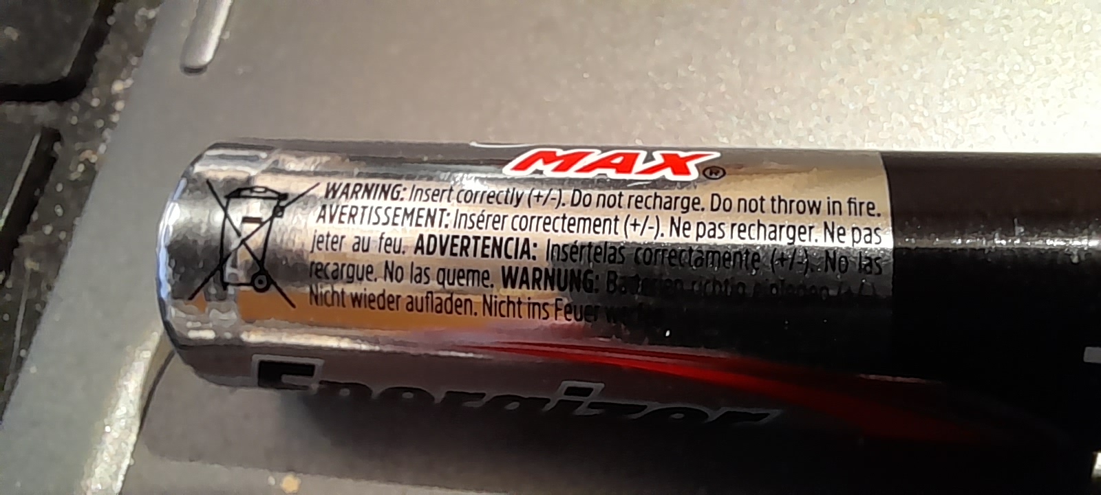

Most secondary cells at 1.3 volt, but not all, I have had some 1.5 volt secondary cells, the big problem is the writing is so small, I often have to wear two pairs of glasses to see using my mobile phone on macro setting yes can read the writing but this View attachment 368199 Is far to small to see with naked eye Warning: Insert correctly (+/-). Do not recharge. Do not throw in fire. Using 4 languages too easy to miss, and most of my rechargeable have a silver label so very easy to get mixed up. And the 1.5V is slightly larger, but still hard to see without two pairs of glasses, so to test batteries by shorting it is far too easy to do it with a secondary cell in error.

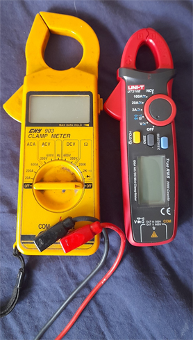

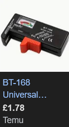

And for me my multi-meter does not have a hard wired amp range,View attachment 368201 so could not test that way even if I wanted to. And at under £2 for correct tester View attachment 368202 why would you want to test with a multi-meter?

Yes the meter has a battery test View attachment 368214 but if one already has a multi-meter, then a battery tester is cheaper. Unless you know exactly what type of battery is being tested and what it is to drive, then all rather pointless.
Thak you again for your help. It makes good sense. I will have a look to see if I can find your battery tester.
I have noticed on the BT68 that they can't be used to test re-chargeable batteries which is a bit of a drawback. Are re-chargeables tested differently ?
Depending on the chemistry, they can be a different voltage, so the result of the test will be different. There is no such thing as a universal battery tester.

I have found the following testers, one is a BT168 : https://www.temu.com/uk/bt-168--tester-quickly-check-aa-aaa-c-d-9v-1-5v-batteries-with-colour-coded-meter-indicators-g-601099523647317.html?top_gallery_url=https://img.kwcdn.com/product/open/2023-08-16/1692185406244-d79be7c520f945f8bf7df3642236e670-goods.jpeg&spec_gallery_id=4022697380&share_token=2EOJ54rfQ7qf4Pv5TrVHvQhujytvO9Q2oiBqTYI_g5Y90Kx0pgL-oU55Kvonqm_6j56-ux4ljFKv2wDDePNoNk9euq51yBs-hNsbEmK75HbJTOUAR7z1nb4tOhRs_VrVD1m7S4GU2x-y3aH3BqhdHo&_x_vst_scene=adg&_x_ads_sub_channel=shopping&_x_ns_prz_type=3&_x_ns_sku_id=17592247380795&_x_ns_gid=601099523647317&_x_ads_channel=google&_x_gmc_account=710731536&_x_login_type=Google&_x_ads_account=6950480996&_x_ads_set=21176691986&_x_ads_id=161751102678&_x_ads_creative_id=696269812531&_x_ns_source=g&_x_ns_gclid=CjwKCAiAm-67BhBlEiwAEVftNp-Q7pTpf0slQdNz_HLMbBV7vtAK09KD5gM2HKA4wuaSaflbP16H_BoCEKoQAvD_BwE&_x_ns_placement=&_x_ns_match_type=&_x_ns_ad_position=&_x_ns_product_id=710731536-17592247380795&_x_ns_target=&_x_ns_devicemodel=&_x_ns_wbraid=Cj4KCAiA-Oi7BhBYEi4AcWKx7Ci7t6OIKLIGQh1xiD2SjIIk7ST2s-SId0L-6LbVj_R8qC34r61_mUeKGgKqiA&_x_ns_gbraid=0AAAAAo4mICEAawanWBW2pMMrpI8g6rl4Y&_x_ns_targetid=pla-2264774463544&refer_page_name=kuiper&refer_page_id=14004_1736158706709_5wm9f29up4&refer_page_sn=14004&_x_sessn_id=zzz2x8uhq1&is_back=1
The other looks very similar but is a BT168D : https://www.temu.com/ul/kuiper/un9....ATaqC8A1qd4UcOA4rn1WwboBlXf_ZvzBoC2BEQAvD_BwE
Both of which were in the link I posted for you.
One tester you found has a digital display, the other analogue, but basic same tester, for the few extra pence may as well have digital, but my main point is they are only a guide, clearly under 1 volt they are US, but as to if they will work or not, depends on what they are going into.
Thak you. I never thougt about D meaning digital !! I'll get one and see how I get on with it but still a shame that re-chargeables can't be tested.
