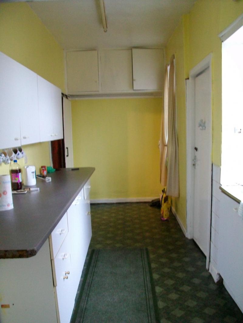

I would preferable like a clear 9m opening, but would be willing to look at alternatives to keep the cost down. The length is currently split between the side of the house (approx 6M) and a single storey extension, which was built with the house of around 4m in length. Would it be easier to split it into these lengths, because I already have a lintel separating the two width wise.
I will add a photo to help.
