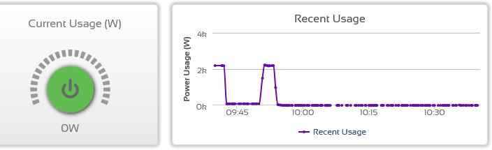

The first peak must be heating the water. So even if you had a hot fill machine the water would have had almost half an hour to cool down whilst being pumped and sprayed around.
That is very different to my result, when I checked mine - you have a short time of heating at the beginning, then a much longer time of water heating long after the wash was completed. Why would it do that?

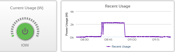

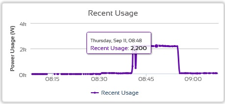

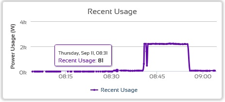

Running at the moment, first the drain pump runs this shows as 81 watts, then water heated 2.2 kW, then the cleaning pump 67 watts. It is unlikely I will catch it all with recent usage, so will add to the post as the cycle goes on.

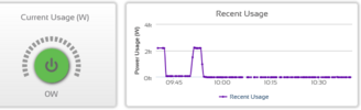

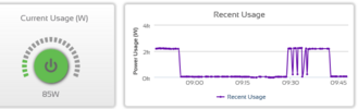

What is going on here? Emptying again, I think
1757579605915.png Yes the heater back on, why pulsed? Washing again 1757580545424.pngseems second lot of hot water. 1757581203658.png still not finished, what is it doing using only 3 watt?
1757583765786.png finished. So used a little more today, it was 1.08 kWh last time.
