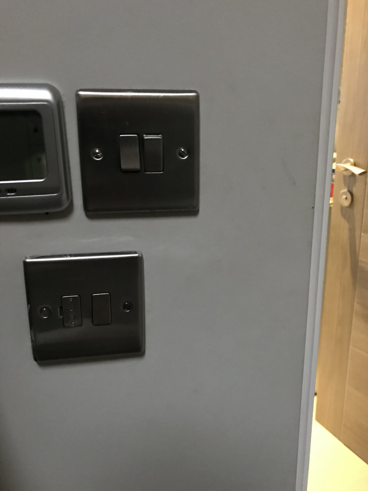

Could I use this motion sensor to trigger an extractor fan?

Could I use one of these to trigger it
If you mean that the sensor triggers a timer in the fan then the answer is almost certainly NO
If you mean the timer in the sensor controls how long the fan runs after movement stops then it might work. It depends on whether the sensor can operate into an inductive load.
I want to walk in the door, the sensor detects me and turns on the fan.
Other wise could I swap this for a 3 way switch and use that for the fan?
If I can get the wire to it.
Then as per the second part of my answer.

Would it work on the switch if I swapped the 2 for a 3? I believe I can have an isolator in the loft.
Dad used PIRs for the fans at their last house - worked well enough. In the bathroom it was the only way really since there were 3 separate lights so triggering from light wasn't practical. He did put a pull cord hidden in the airing cupboard so it could be turned off - and it wasn't so noisy as to be a problem at night.
Yes, a 3 gang switch would be fine.
An isolator is not, strictly speaking, required but is a good idea and can be placed near the fan.
That looks like a switched fused connection unit - it would be impractical to swap it unless you want to change the backbox to a double so you can have a three-gang grid with a fuseholder and two switches.
EDIT: Oops, now I look closer I see it is two switches :whistle:

Ok, thanks for the advice so far.
I’m thinking to get rid of the PIR idea and stick to a switch.
The bathroom wall is made of 4x2 and between the double light switch and ceiling will be a couple of noggins that would make it hard to get any wire through. That leaves us with a pull switch and my missus would be happy with a chrome one.
It could possibly go outside the bathroom here:
Inside the bathroom (if it’s allowed) here:
And the loft is converted but I can get above it here (green boards are in the bathroom, pink are in the hall):
Where is the best place?
