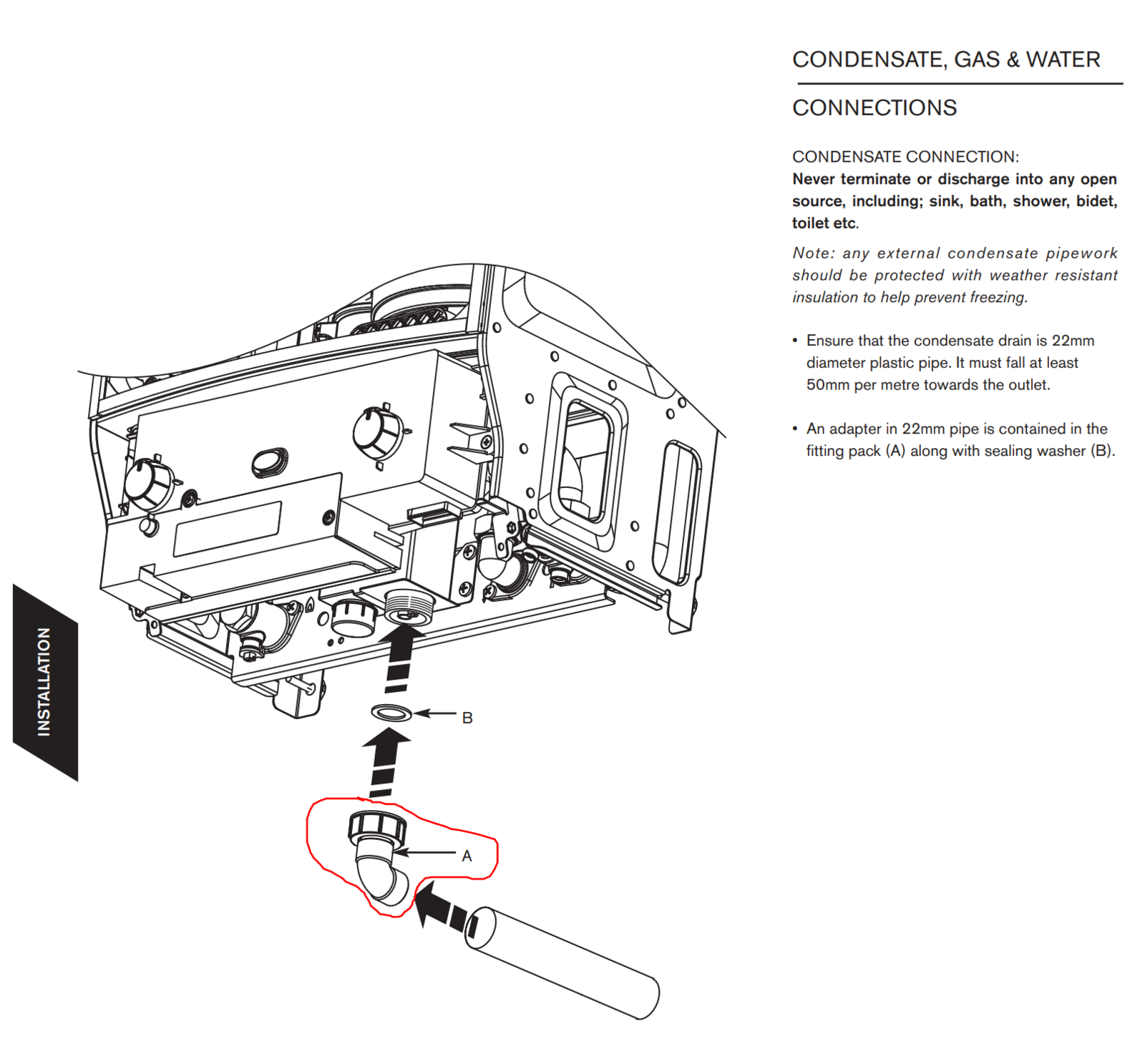

I have a Worcester Greenstart Ri bolier and we noticed water is dripping from underneath. On further inspection I can see there is crack in the bend of the condensate pipe.
Really annoying as we only had it serviced a few weeks ago!?
I include some photos below.
I have no experience in plumbing so was wondering how I would go about fixing this?
In the picture below from the manual I assume I need to replace the part labelled A?
Is this a special item particular to this boiler as I can't see it on screwfix and the like?
I found this which seems to be it:
https://www.dhsspares.co.uk/product/worcester-87161070290-elbow-assy-siphon-outlet-1015117
I guess I will have to cut the pipe going into the existing one so will I then need to extend it to be able to attach the new one?
Would I then attach the pipe to the new bend (labelled A in diagram) using solvent cement?
