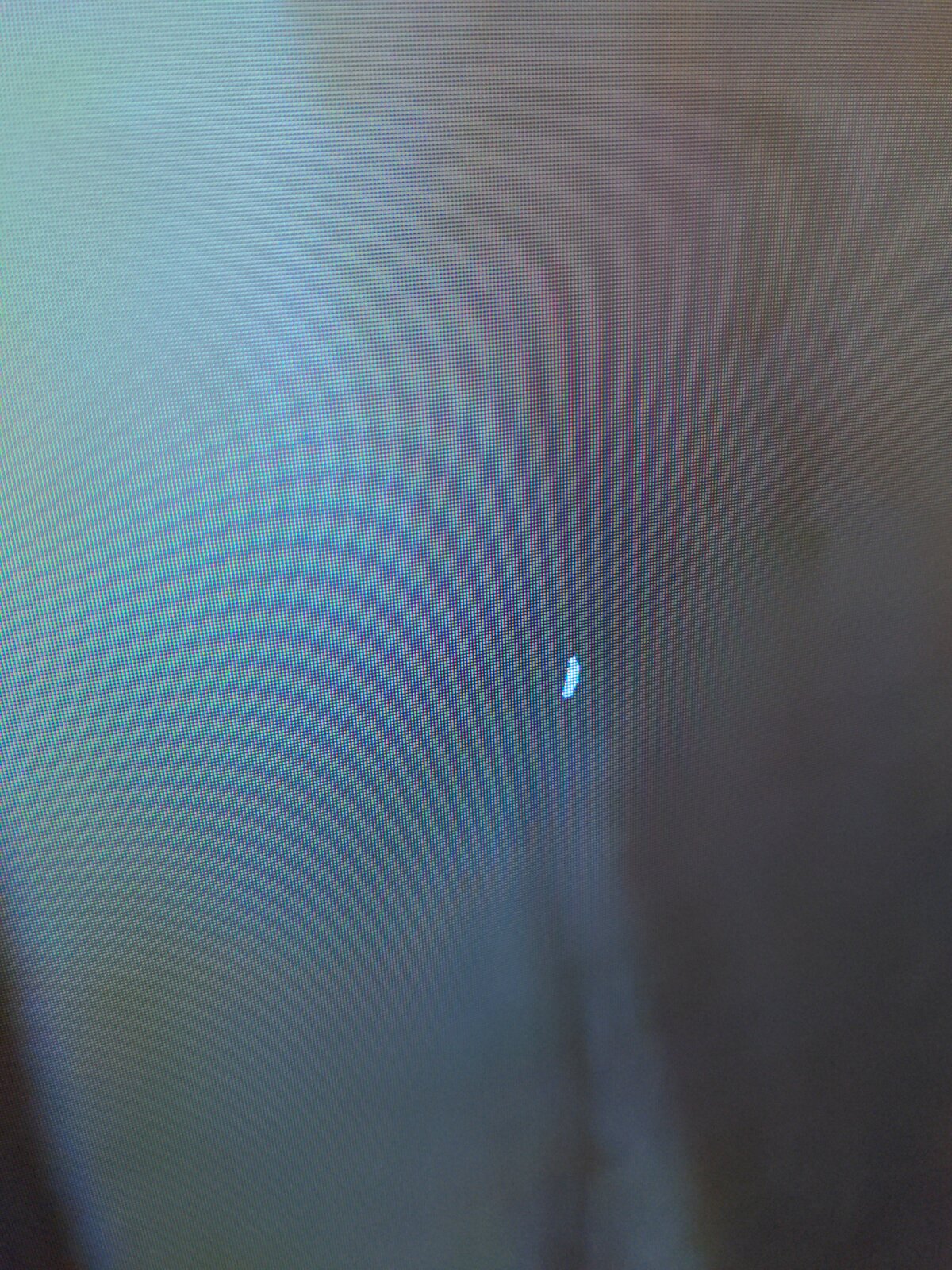

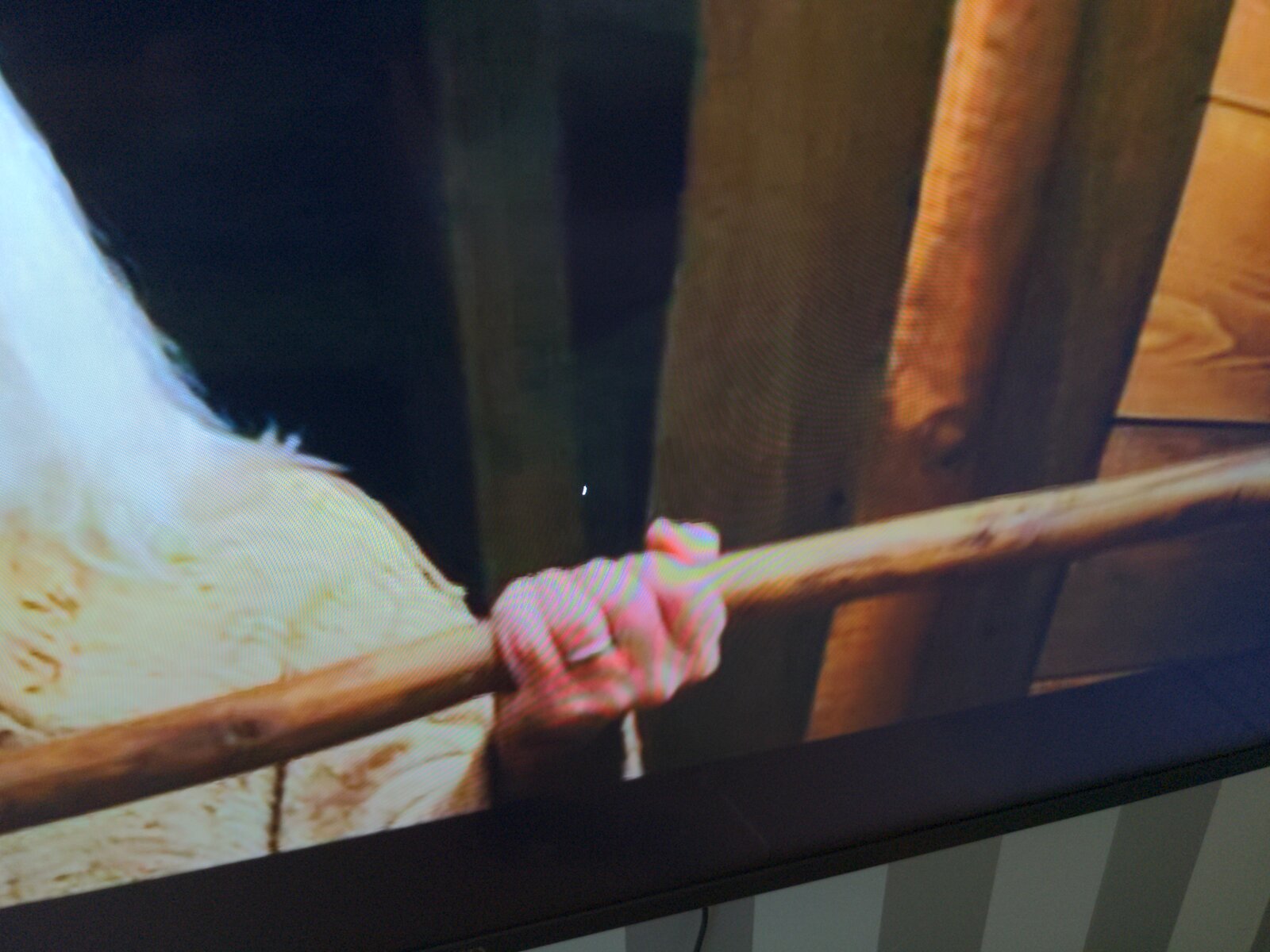

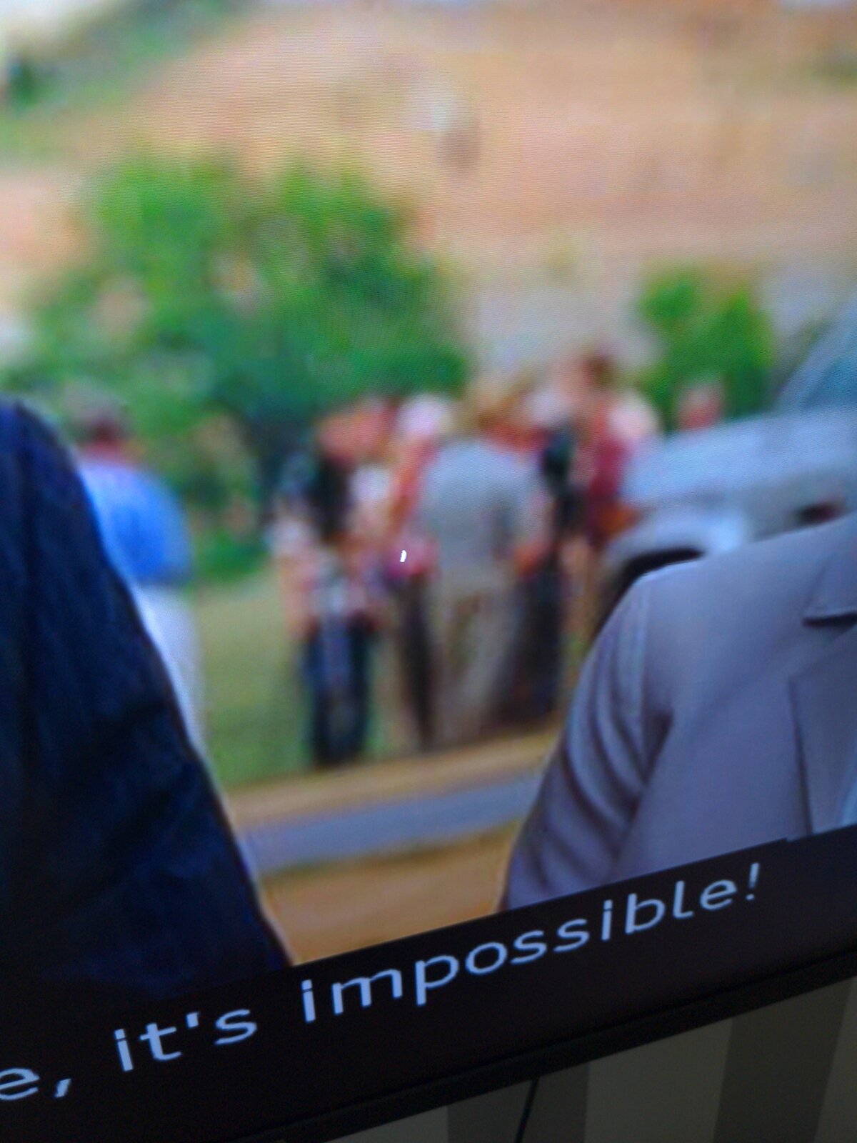

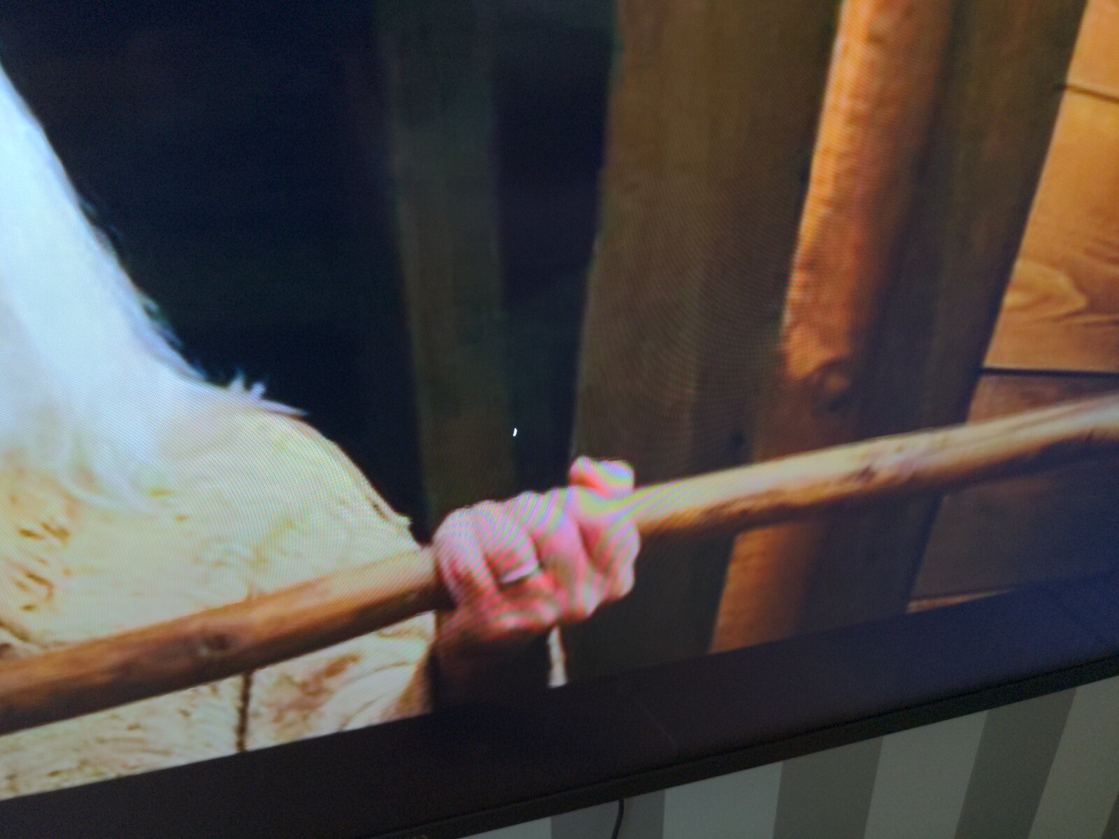

Hi I accidentally knocked the TV screen whilst putting on a bracket.
I have been left with a small scratch/ crack to the TV screen and a small white spot.
Any thoughts ? Is there an easy fix for this.

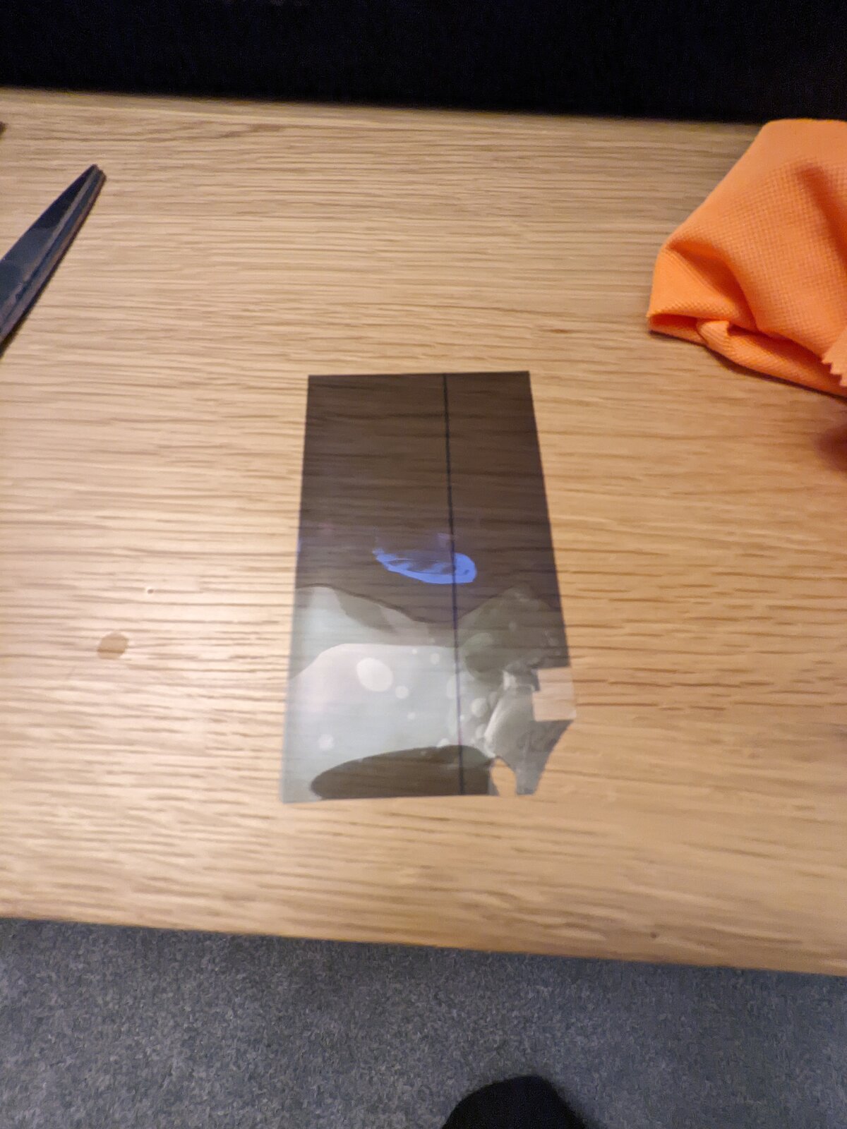

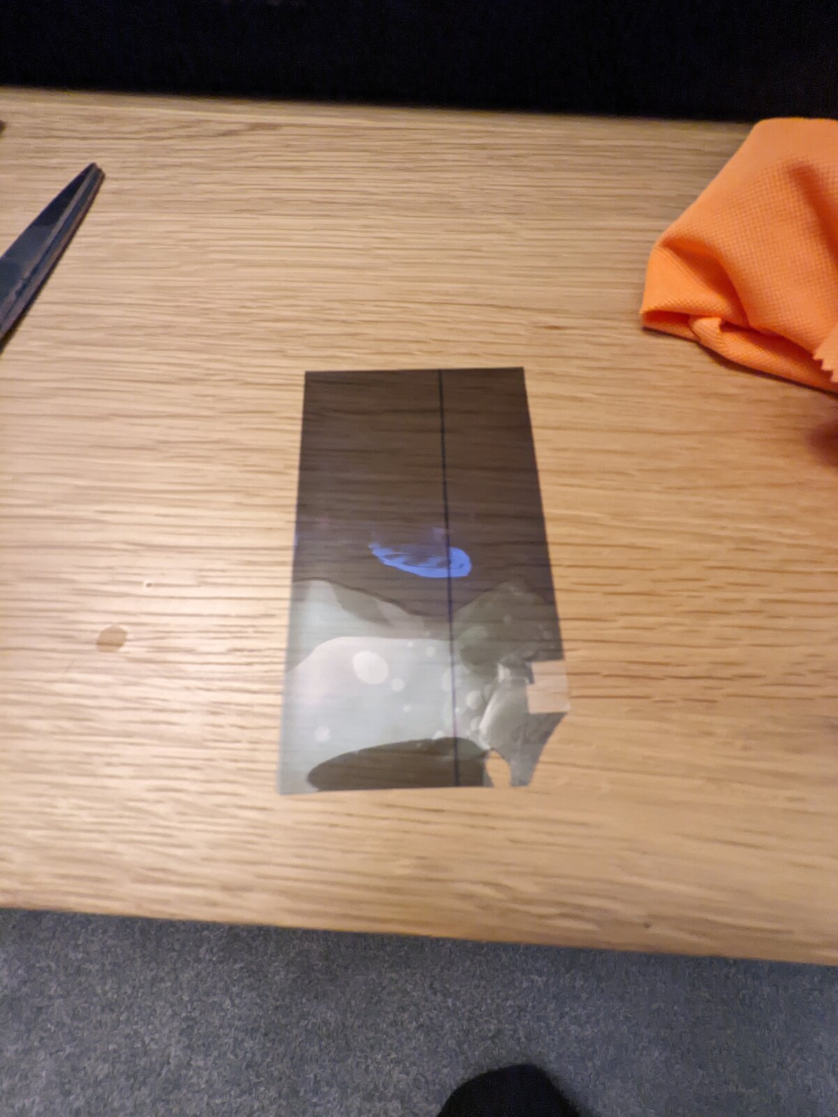

I have read around and the fix is hopefully as simple as cutting and applying a £2 piece of polarising film over the white part.
Will post if it works later in the week. :)

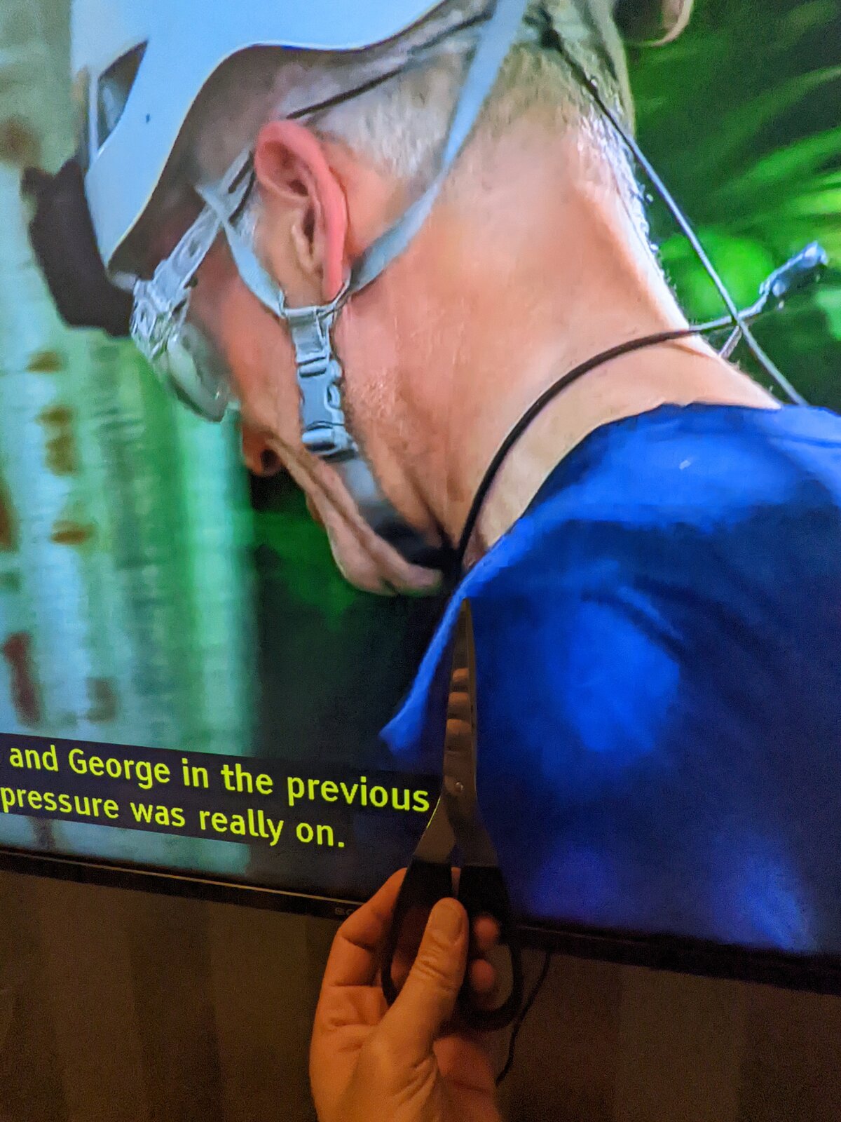

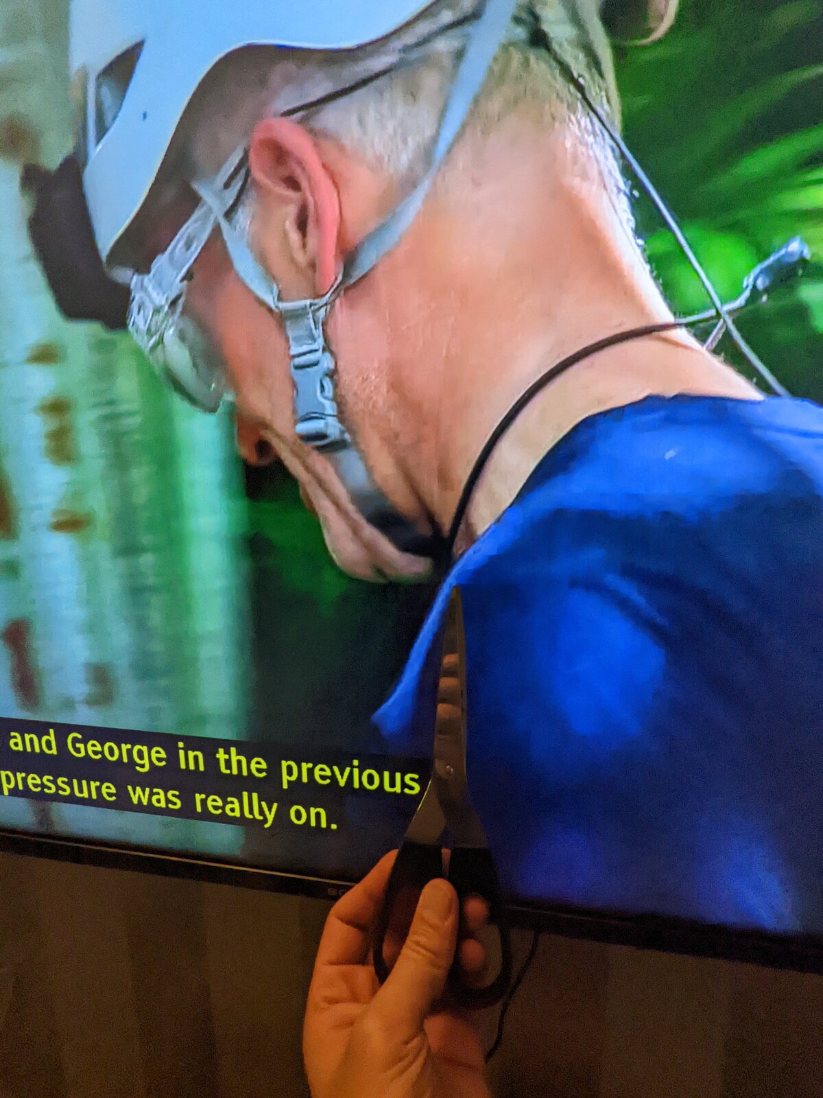

Just an update managed to DIY the crack to the screen. On reading a TV has an led glass screen with a polarising film on top.
It appears a little of my polarising film was scraped off. You can check it's the film by wearing some polaisring sun glasses and the crack was not visible.
I found some polarising iPhone film on eBay for 2 pounds. After cutting a small section out and sticking it on the problem has been solved !!! Previous cracked area pointed at with scissor tips.
