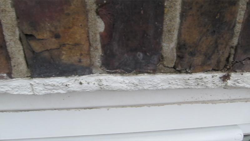

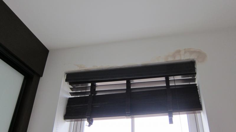

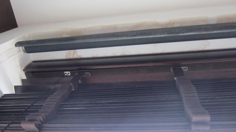

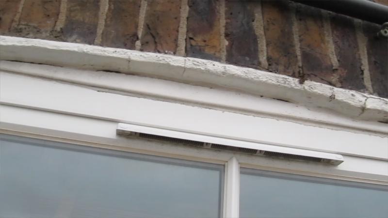

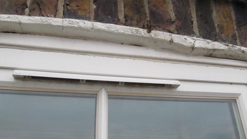

Hi
I have a window in my apartment on the 3rd floor of the building which has cracked brickwork above it. The brickwork is causing water damage on the inside of the bedroom where the window is. Seems on days where there is heavy rain the brickwork is soaking up the water via capilliary action etc and causing damp and paintwork/plaster problems on the inside. I have taken photos. Please see attached. The question is can I render over the section with the damaged brickwork to stop the problems. The other cause I have solved as there were areas where the putty in the window frame had fallen out over time and water was coming into the brickwork via that route. I have filled those gaps using a external building sealant. If any one can give any tips on which product to use to fill in the cracks above the brickwork. Please note I cant replace the bricks as the building is very tall and getting access the level where the window frame is is very difficult and would require a huge scaffold framework to be built. However you can lean out of the window and easily reach that area where the cracks are. Provided I wear a harness it should be ok to do. So please take the time to look at my photos and offer any advice you can. Thanks in advance for any replies.
regards
dukes

I doubt its just a crack that needs filing. It may require a new mortar fillet on top of those tiles, or resealing between the frame and arch. Or it could be a bigger problem of water penetrating further up. None of which is a job for hanging out of a window
If you are already on bad terms, then getting the council to serve a statutory nuisance claim on the landlord, will give him 21 days to sort it out, or face the magistrates court
If you're lucky, it could just be water getting in those gaps in the sealant under the arch. Some sealant might just sort the problem. If you're very lucky. If not, I think you're stuck with it.
