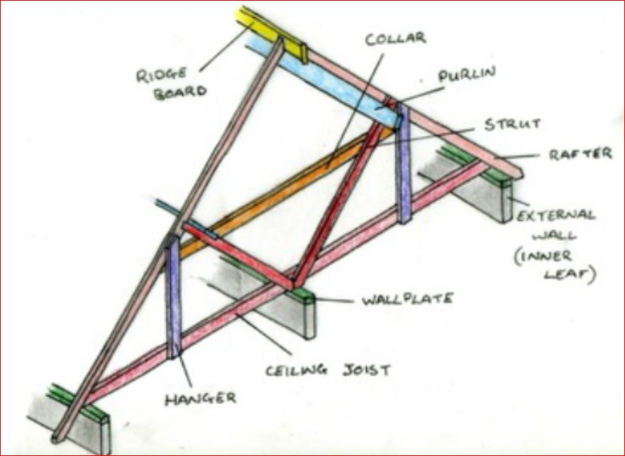

do you mean they are undersized or oversized and by shape you mean bowed ?
No I mean a slate roof with decent purlins in a caved in shape. The purlins would have been fine if the struts were still there..
Only one of the 4 purlins is showing signs of bowing (now cracked). In the roof space originally there were no struts only thin timbers which hung the original thin ceiling joists to the rafters.
You are referring to the components called collar/strut in my attached cutroof pic. As I mentioned earlier a survey had indicated that there appeared to have been some settlement but it was not thought serious enough to impact a mortgage, whether they actually looked in the loft seems doubtful.

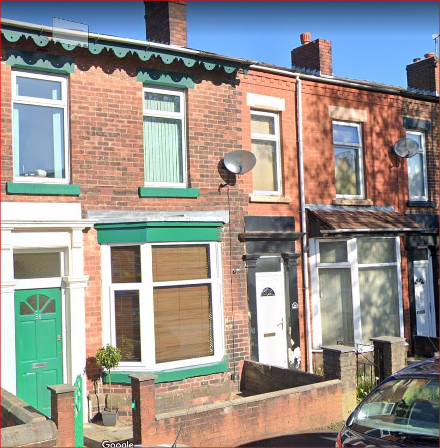

unfortunately i did not take more pics of the roof assembly, but trust me there are 2 purlins per pitch, i cannot readily get more pics as i am in Germany and the house is not !
The purlins look to be all original equipment ie not assembled later, all same dimensions rough cut and the same degree of "patina".
By "all supporting framework removed" do you mean the so called collar and struts referred to earlier by another poster ? I cannot imagine why a previous owner would do that because when I took it over the loft
was not a usable space there does not appear to be a logical reason for its removal, assuming it was there. Not sure if it is relevant but this house appears to have been at one time an end of terrace although now it is mid terrace, the house adjoining what might have been the end is a completely different internal structure, it is 2 bedroom not three, bathroom is in a different place and no two storey outrigger. Would an and terrace need more support in the roof ? in pic green paint is mine to the right is a different construction

on the left (rear) pitch i took out the complete chimney to floor level. There is a concrete lintel supporting the new brick that was inserted to bring the inner skin up to roof level and the roof was patched over.
This is not the side which has split. I am not entirely sure but I think that we had some mortar left over and as the mortar around the two visible pockets was decayed it was raked out and the excess mortar used to patch it up.
Is the loft chimney breast lower down the party wall?
Both chimney breasts are entirely in my building, rear is now removed front untouched. There is a picture on pg.1 which shows my front stack, that is under my neighbours entrance hall his chimney is on the other side
