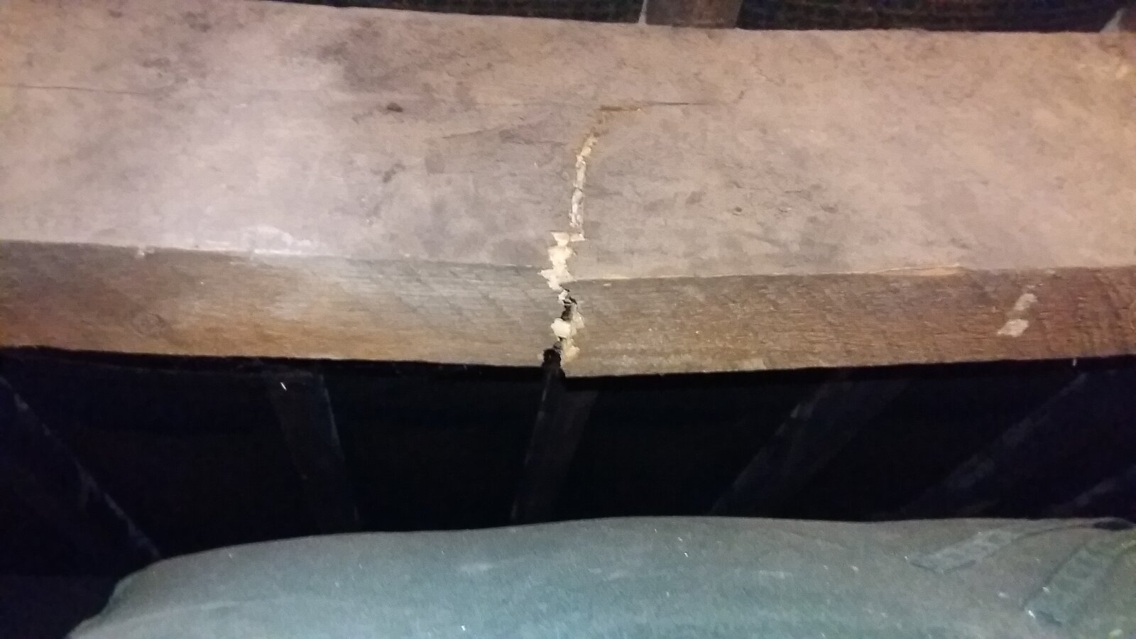

Hello DIYers,

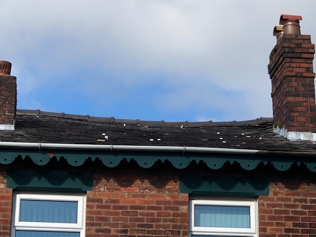

3 bedroom mid sized terrace with slated, relatively shallow pitches circa 1900, 2 purlins per pitch. One purlin has been bowed for many years and seemed stable, now a severe crack both vertically at the lowest point of the purlin and also longitudinally has appeared.
Ridge has cracked and there is roof sagging at the ridge and at the cracked purlin.
The purlin depicted is the upper of the two on this pitch.
My intention is to remove the roof entirely and replace all structural elements, 4 purlins, ridge, all rafters, slate battens, new felt, lead, warm roof insulation, re-use slates.

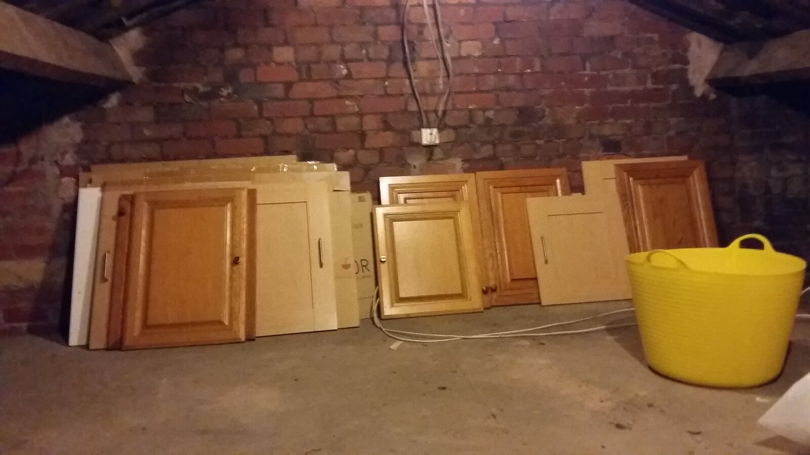

Do you definitely have slates, not tiles, bearing down on the roof framing?
Maybe, to give more room space and head height, you've removed previous supporting braces and collars in the loft?

The original roof had thin struts attached to the rafters which supported the frame from which the bedroom ceilings were attached. Since then a load bearing loft floor is installed so the struts are removed

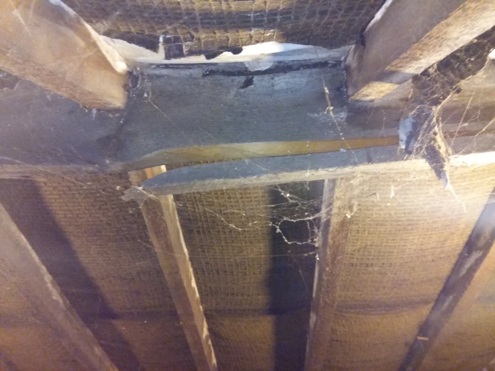

Image ending 531 (ridge is concerning.. whats that white stuff? Just the paper from the underlay or something more sinister?
Load bearing floor ? what about supporting the roof?

Bit of spread going on? I think I would get it properly checked out.

If that purlin has snapped, it could be because of a defect or because it was undersized - in which case it's not a like for like replacement anyway, and you need to be sure that a suitable section of beam/purlin is put back in. That's why it needs assessing by a person who knows about structures.
In the same context, when the purlin snapped and the ridge dropped, something happened to the rafter ends on the wall. They either pushed over the wall or they stayed connected and pushed the wall. So you need to be sure that any required remedial work is done to the wall, and the whole thing suitably braced. Again, a job for someone who knows about structures, not a roofer or anybody just looking for any cracks.

@Data - you mean the staining on the rafters, I do not know its on all the rafters on both pitches or do you mean the white area at the top of the pic, that's just a trick of the light it looks like a big hole and the sun is streaming through in reality it was ****ing down when this was taken
Load bearing floor ? - in that the original joists/ceiling support timbers are removed and replaced with i think 5 or 6 inch certified timbers in order to board out.
what about supporting the roof? - can you elaborate ?
