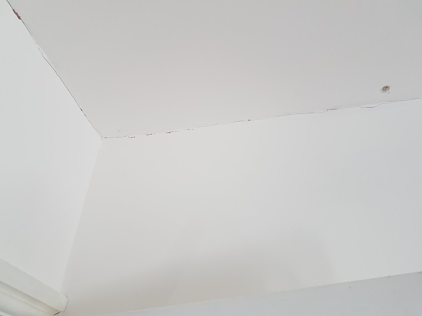

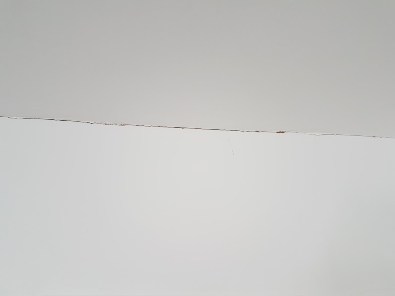

Is there a way to solved this problem of cracks around ceiling/ tops of wall. I am thinking when the house got plastered the plasterer has not put a internal scrim where ceiling meets wall.
I was thinking of caulking it but will this crack again?

You can caulk it, but it'll need redoing every year or so as the room expands and contracts. They should have scrim taped it, but it's still no guarantee, and covings pretty much the only real answer. So the dining room is the only one with coving; why worry.

If you caulk it with enough caulk to run your thumb along it. It will take the expansion and contraction of daily life so crack on ...
This is in a rented property , think ill go with caulk then if come back coving it. Buy me a year as well to fit it in .
Thank you for reply's guys
AAh
Makes sense not to spend time and effort fitting coving when caulk will act as an interim measure?
If that was my lid I would tape and joint the edge for a good finish but it would mean repainting but as it's not your gaff I would just caulk it
That''s exactly what I'd do, tape it with scrim tape, cover the tape neatly with a couple coats of ready mix, sand it down when dried out, then paint it.
