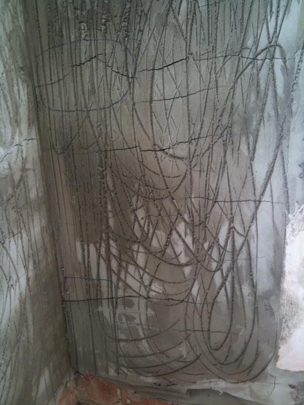

I've had somebody render wall where the bath is going to be. I stripped off the old plaster/sand and cement myself back to bare brickwork, wirebrushed it.
He's left it with a scratched finish, presumably as a key for tile adhesive. I'll be doing the tiling.

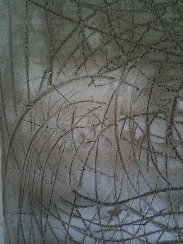

But there are lots of cracks and a couple of spots where it sounds like it's blown. Should there be cracks in this? The whole point of having it sand and cement rendered (with waterproofer added) was to create a waterproof substrate for tiling. I told the plasterer to treat it as a 'tanking' job. It's obviously not waterproof if its full of cracks.
Did he give the old brickwork a good soak down?? It could be that the render has dried in too quickly, onto the brickwork. Is this 2 coat render? ie, did he scratch coat, then top coat render,,, (left off the scratch float), or did he bring it out in "one" coat? It's not much good for tiling onto if areas are cracked/sounding hollow!
Not sure how he did it, I wasn't here.
There's no sign of much wetting/PVA having been applied - i.e. not sign of stuff running down the wall on the 18 inches of unrendered stuff at the bottom.

As RC says. It could be
dried too quickly
coat too heavy
one coat where two needed
sand too 'soft' (3mm down for rendering, not builders/brickies sand)
combination of above

As it cures, which I assume is what's happening as it turns a lighter shade of gray, more small cracks are appearing. Or maybe I'm just noticing them.
It appears from my looking on th'internet that sand and cement render often cracks.
The small cracks I can cope with. I'll fill with something (external filler?) and move on. What worries me a LOT more is that the render isn't adhering to the wall properly. It generally sounds OK, thought I've found 3 small spots, all next to larger cracks where it sounds hollow.

Hairline cracks are not so much of an issue IF it is sound, ie not hollow . I would not bother filling them if you are tiling over.
As for saying s/c is not ideal for tiles, then the man is, politely, wrong. Sand and cement render onto block (or brick) is the industry standard for tiling onto, for a variety of reasons.
If he does not know this, then he really does not know about rendering, with obviously no experience of rendering for tiling. Not giving you an acceptable alternative (perhaps hardwall and set) just highlights this.This makes you doubt if he did it properly - ie prep, mix , application etc.
You don't need the render to be rock hard, too strong can lead to cracking.
A standard application would be 4:1 sand and cement with w/p (or plasticiser) onto a dampened , dust free surface . Done properly, it will last as long as the house is standing. Most tilers dont even want it devilled up (the scratch marks)
What ever about it being plumb and true for tiles (which it should be) , you have every right to insist that it has adhered to the wall before you tile it.
If you get the 'live' patches off, you may be able to get in behind the render and get more off. Sight unseen, if you have checked it all and just have a fgew patches, then re doing them should be okay - but chek that it is acceptable for tiling -reveals all square with even margins, angles plumb, ceiling other lines straight (where your bath goes, if you are putting a mirror up etc.

OK, just to find out I did this, just now.
Took a 4lb lump hammer and 1 inch cold chisel to a few edges that would be hidden by the bath.
It fell away very very easily. I hardly put any effort in and I'm a 52 year old sedentary worker!!
It fell away from the wall in one piece and didn't leave anything on the bricks. It appears there's no adherence worth speaking of.
If the rest of it comes away that easily I feel quite happy to get it all off now. But is it going to get a lot stronger as it cures?
