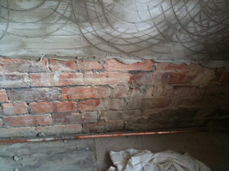

Cracks in new render on bathroom wall?
It will get harder as it cures, but it will not adhere any better. If anything it will lift off the background as it dries.
So, get what you can off now. Those cracks are not hairline cracks I'm afraid.

More pics. This is the bottom 18" or so of the wall, the unrendered bit behind where the bath will be.
So you can see old bricks, wide joints and unlike the facing bricks on the outside of the house (which are hard sods, almost engineering bricks) pretty soft and absorbant. I just threw an egg cup of water over it and it went in pretty fast. Yet I can't see any evidence of any water/PVA having gone on the wall. I'd expect to see lots of 'runs'. I remember plasterers giving walls, especially old walls, a pretty good 'degging' as they seemed to call it, before any browing went on.
The annoying thing is I did a lot of prep for him. A lot more than most householders would. I cut a nice clean edge with an angle grinder (yummy, nice and dusty). The floor was clear, I ran a hose out to the front of the house, dragged the bath well clear and covered it in blankets, got dust sheets out, covered the open ends of plumbing and so on. In other words all the things that a good labourer would do, short of actually mixing. I marked the wall up saying where I wanted the render to start, but he ignored that and at one point it's too high, which is why I haven't paid him yet. And because he didn't do that I haven't fixed the bath so I've had to replumb the bath, rerunning the supplies and waste. Right in the middle of the room.
Parts of it might well be OK. But given how badly other parts of it have cracked, and that there already seem to be blown patches, I haven't got confidence. And confidence is what I want. The tiles I'm looking at (correcting, my wife is looking at) are going to add up to £900. If they start coming off in 5 years I'll be well miffed, as no doubt I won't be able to get any more. And I'm b*****d if I'm goint to buy and store 5 square ms at £60/m2 just 'in case'.
