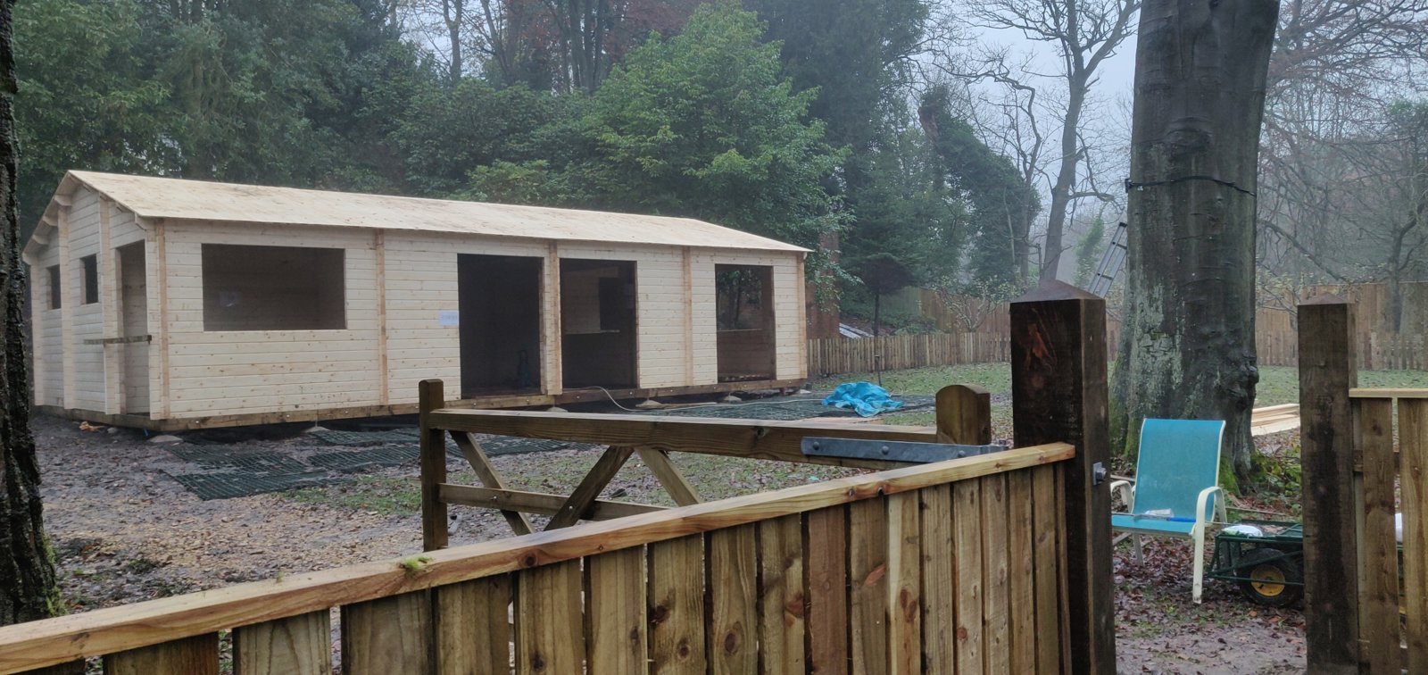

Here's a photo of our site by the way.
Entrance is the door on the left with the bar across, you can hopefully see the access route despite the mud.

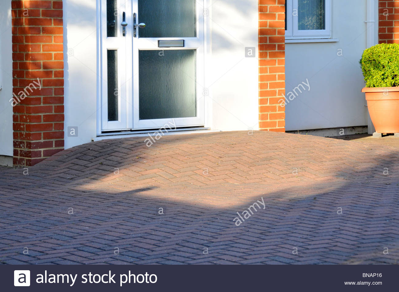

This sort of thing but with level area landing outside door and sloping away more gradually with maximum 1 in 12 gradient.
